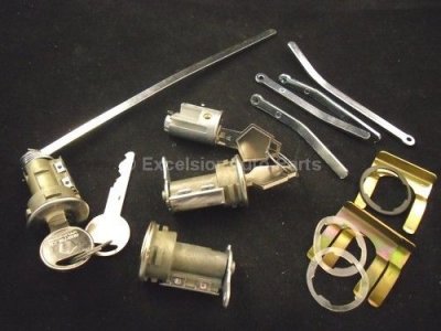

OK I am looking at this on ebay:
Seems to be the way to go.
I still see that the ignition barrel will need to be 'slid' into the dash bezel/housing anyway. So what keeps it in there?
