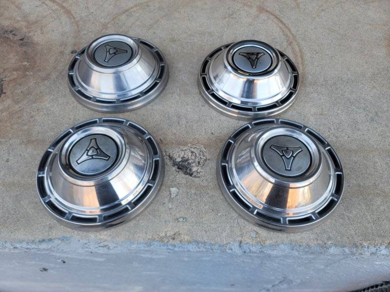

I would like to use era correct steel wheels on my 65 Coronet. The steel wheels from speedway accept 10 1/8" caps. Does that Sound correct?
Thanks in advance...
THEY DO NOT . I have the same caps that will not fit my speedway 15" wheels .... I will need to check what I ordered....
The 10"caps are the early big caps. To the best of my knowledge, nobody makes aftermarket wheels for them .
All the aftermarket wheels are for 9"caps
I believe DUSTER22 (or something like that) had big cap centers made, but you'd have to find somebody to weld them to hoops.
Edit: could be Duster22, or duster22. The man's name is Frank.
Wheelsmith has them. They list the hubcap as 10 1/8 inside diameter.
