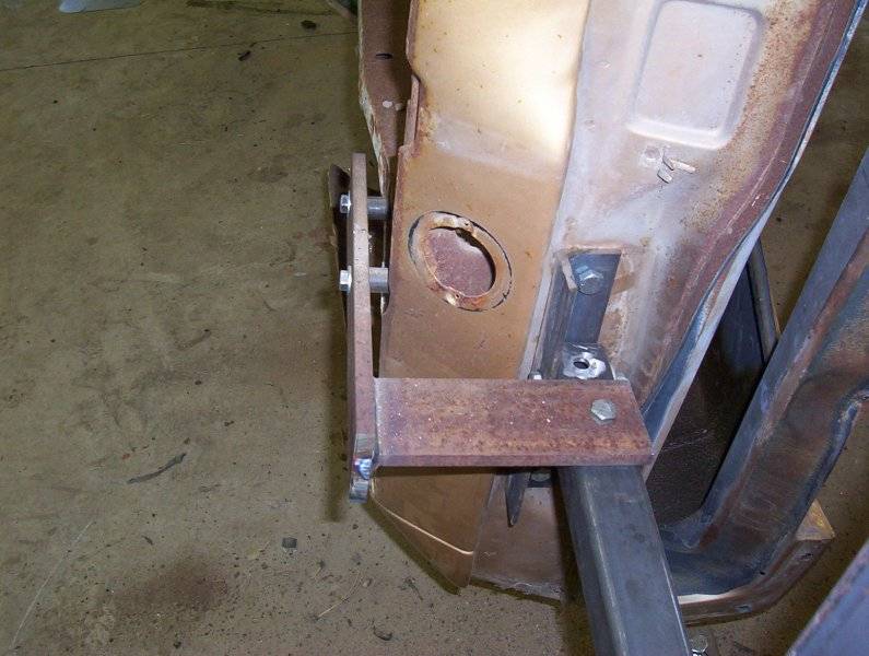

If your car is on a rotisserie how is it mounted? What adapters did you use and what do they look like, thanks.

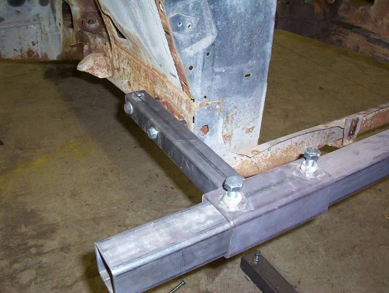

A lot depends on which year and model car you are working on. Here are some on a 69 Charger.

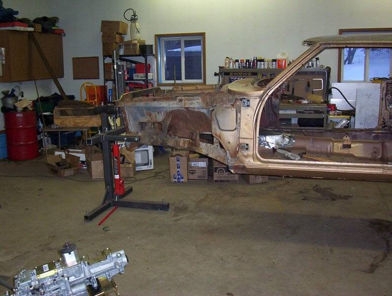

On my 65 Belvedere: Just like the last photo in post#3 only on the rear and no adapters on the front at all.
Mike

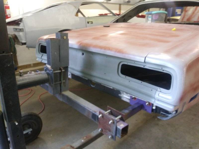

My 64 Savoy has similar mounts as Mike’s. A couple of pieces of heavy angle iron bolted at the rear to the bumper brackets holes. Fronts are a couple of pieces of channel bolted to the front bumper mounting holes.

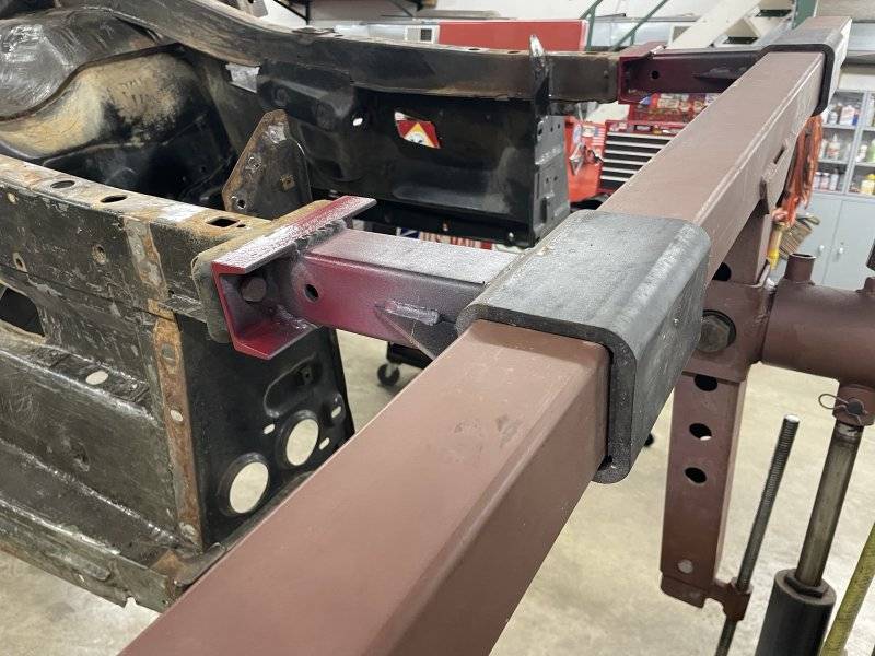

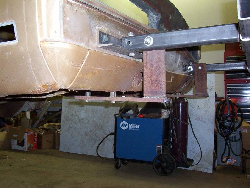

I posted pics on Members Project. I used the tubes that came with the lift for the front and used an 2" angle for the back and bolted to the lift Simple
