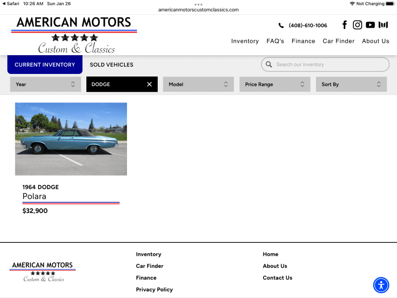

Plan to look tomorrow. Monday. Any 64 experts direct me to known areas underneath etc. lots of pics on the site, but not much undercarriage. I’m also ignorant of convertible particularities. Thanks. This is a screenshot.

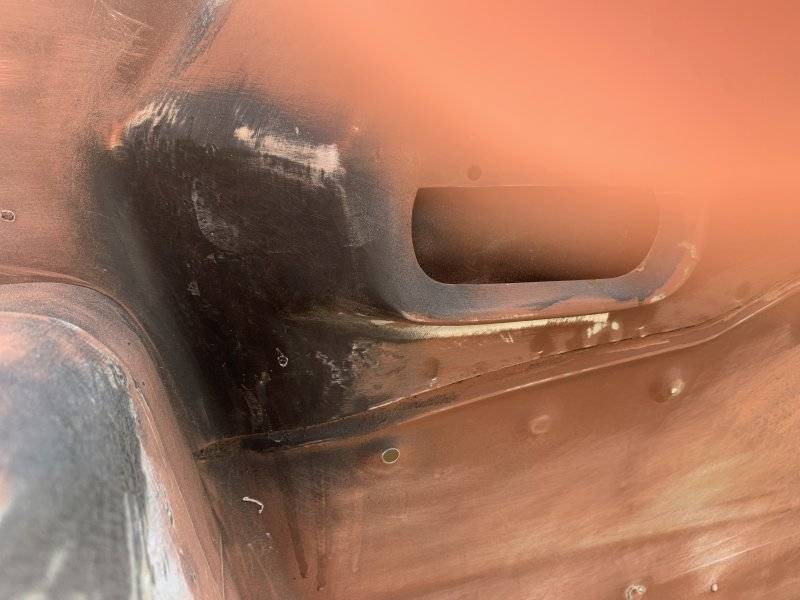

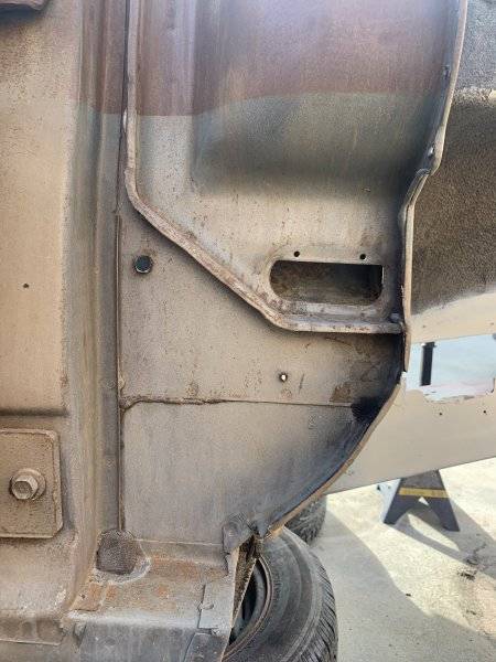

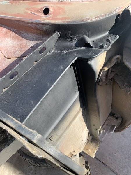

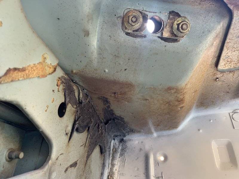

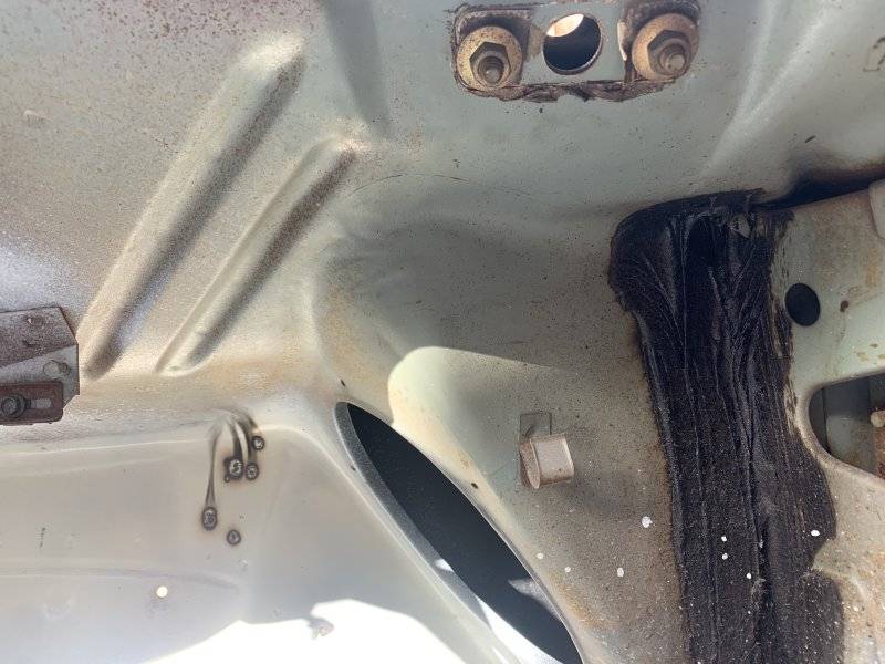

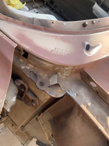

Need to get up under dash. These cars will rot from driver and passenger cowl. They will also rot through firewall drain on passenger side. Unfortunately really hard to see with car fully assembled. These are pics of my 65 satellite vert project. Message if you need anything else.

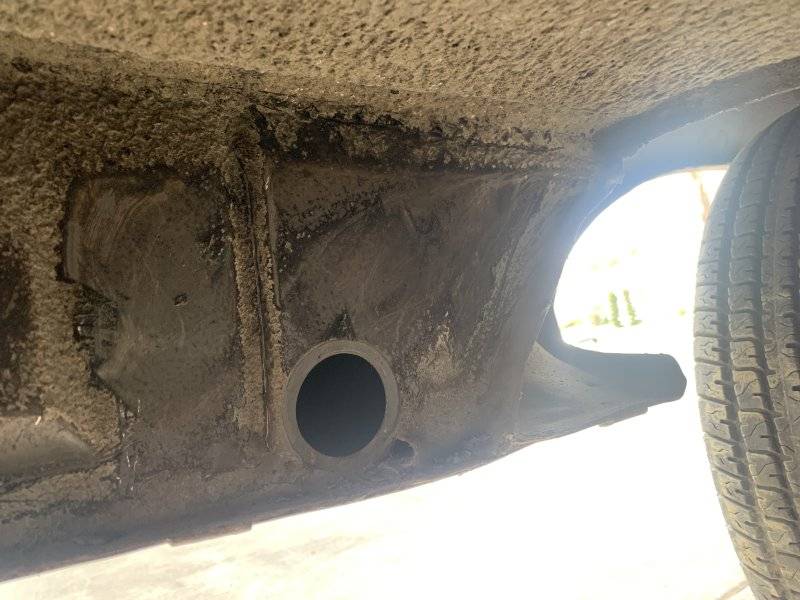

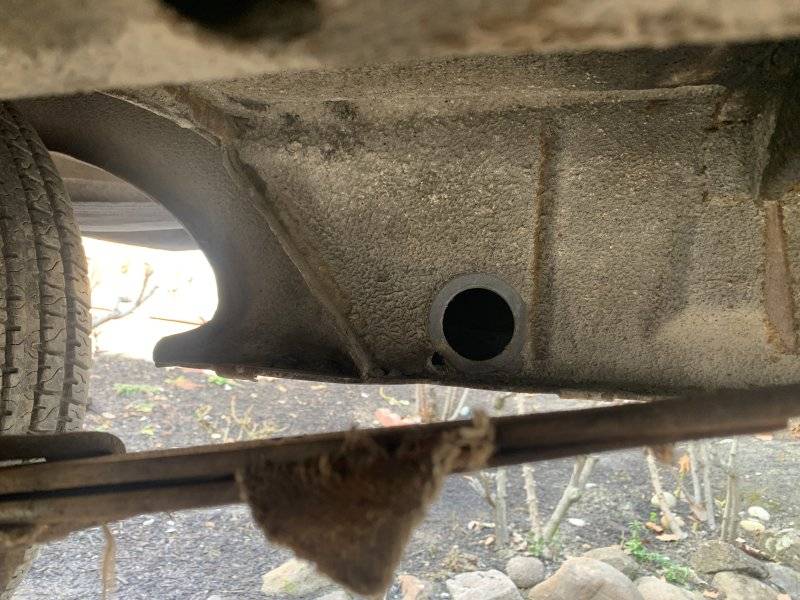

Not necessarily Mopar related but I have found hidden rust on convertibles on the inner rear fenders at the ends of the top. You can usually see this area by looking forward from the left and right inside of the trunk. You'll want a flashlight (and flexibility) for this.
