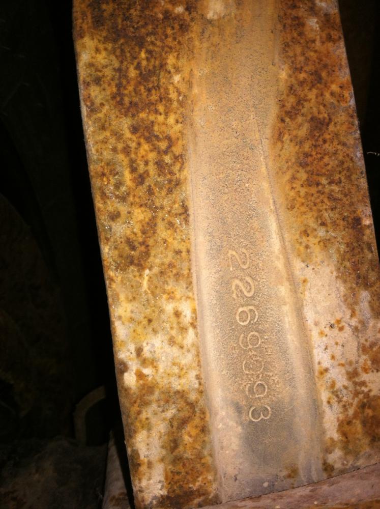

Anyone know the p/n for max wedge/heavy duty leaf springs in 62?
Rolling Thunder
8:58 PM
Sep 11, 2009
628
311
Trenton, IL
Are these springs on my cop car the same as used on max wedge cars? P/N on mine are 2269993. Thanks. photo.jpg
Are these springs on my cop car the same as used on max wedge cars? P/N on mine are 2269993. Thanks.View attachment 101835
Rolling Thunder
The information I have shows for 62-63 there was no special Maximum Performance spring ,part number 2275862 was used on both sides and it was the heavy duty police,taxi,and station wagon spring. A factory bulletin suggested part number 2196937 be used on the right rear as an option.
Hope this helps
Jeff
