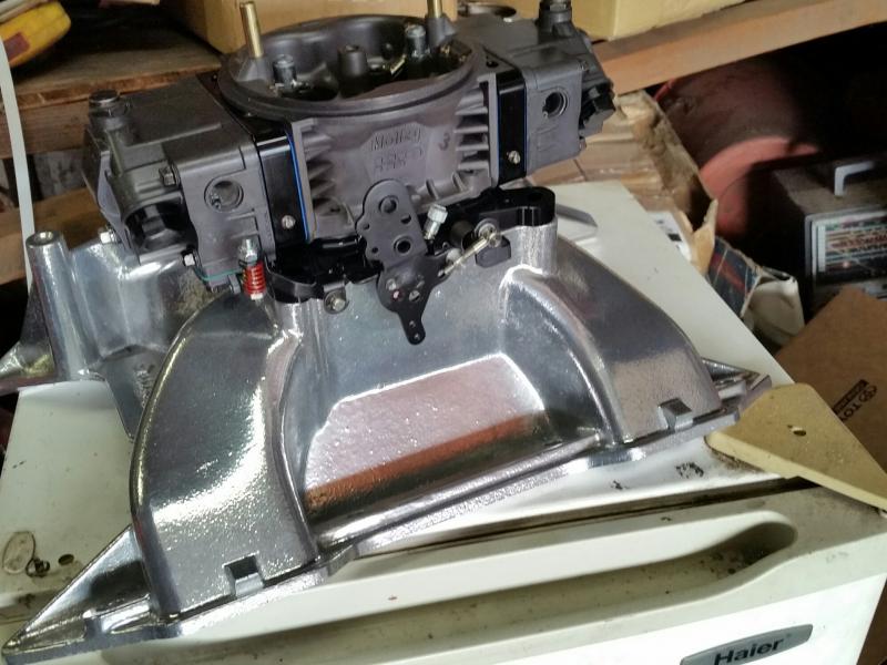

another option i do for extra heat dissipation is using a thermal bearier coating, got my M1 back from Nitro Plate recently.
Let us know how that works. Electric fuel pump is not the answer.
