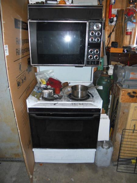

I've got some hi-temp grey powdercoat material I bought from Eastwood to do mine with. Just hav'nt got that far yet. I do have a converted home oven that I've been using for other small parts though. I probably have enough of that grey that you can use some of it.

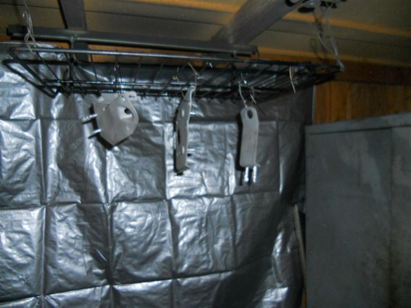

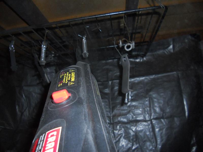

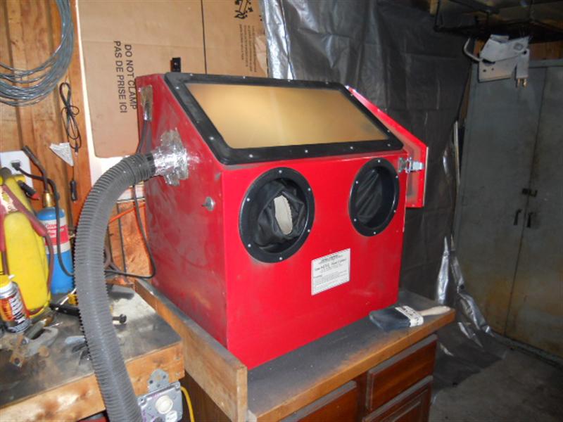

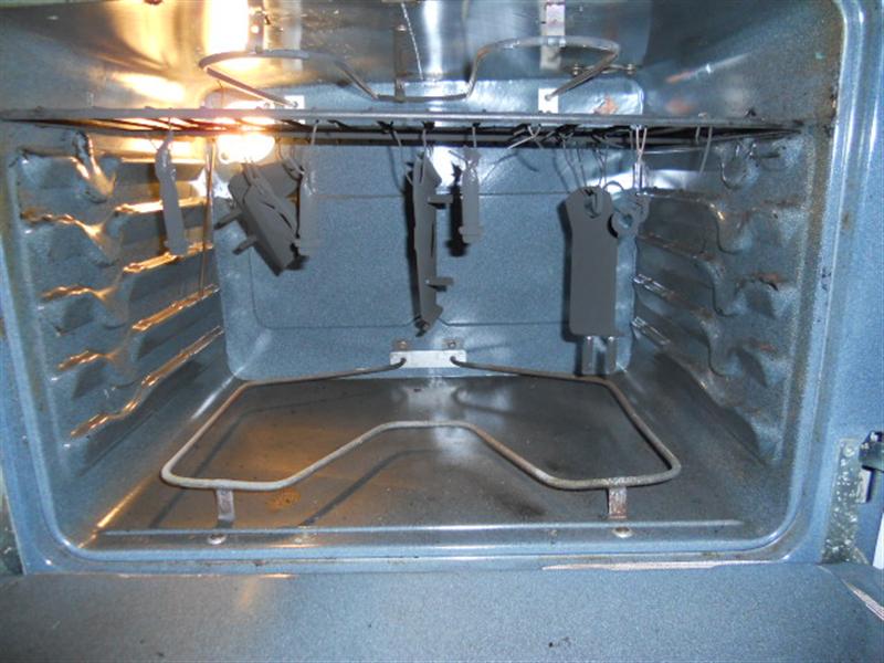

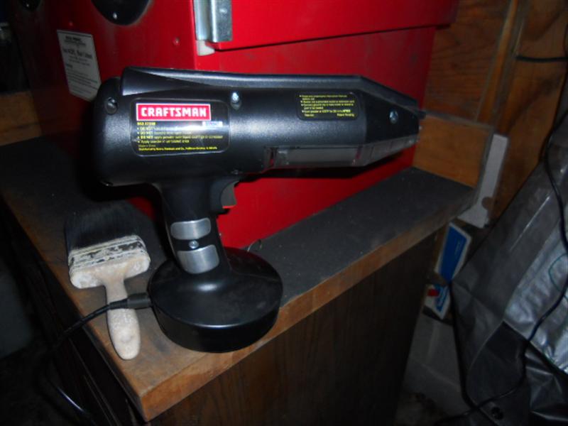

I work with a household range I got free from Craigslist, it is an older unit that has a small upper oven that is great for small parts. If you have a blast cabinet already the auctual powdercoat process doesn't require a whole lot of room. I hang some plastic sheeting in a corner of the shop, with the old racks out of the oven used to suspend the parts, and go at it. When I'm done the only shop space taken up is from the 30" range. I got the Sears powdercoat kit off E-Bay for $40 and it is decent for the amount of work I do.

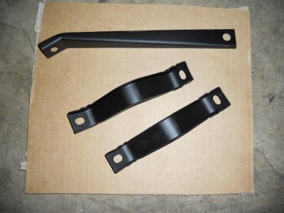

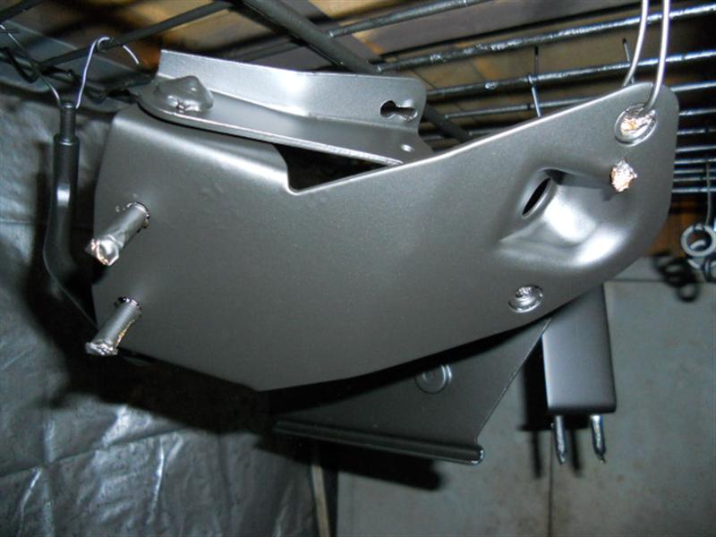

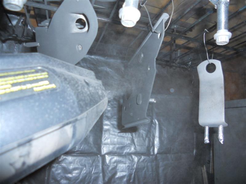

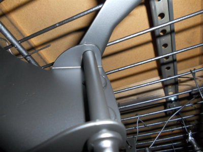

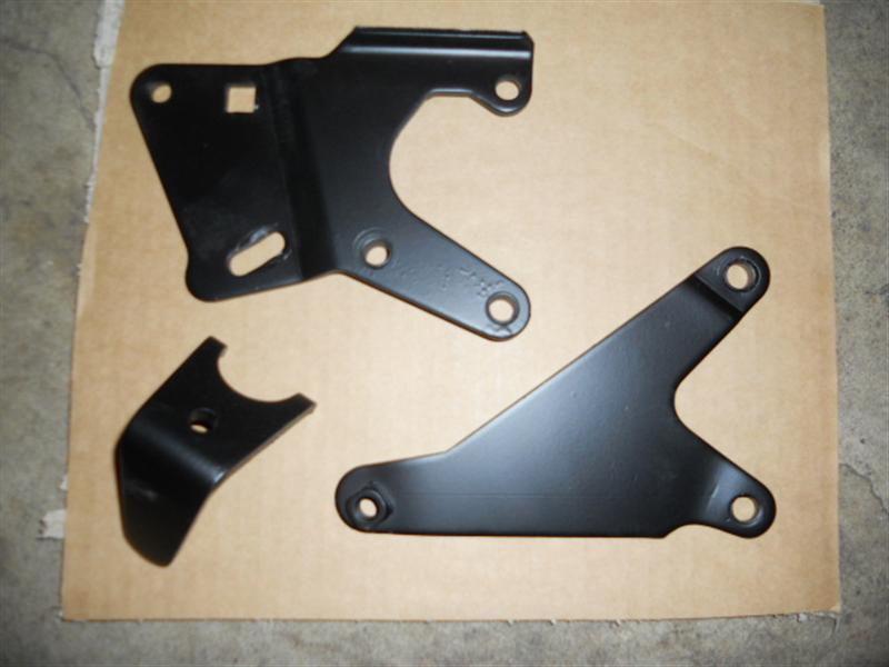

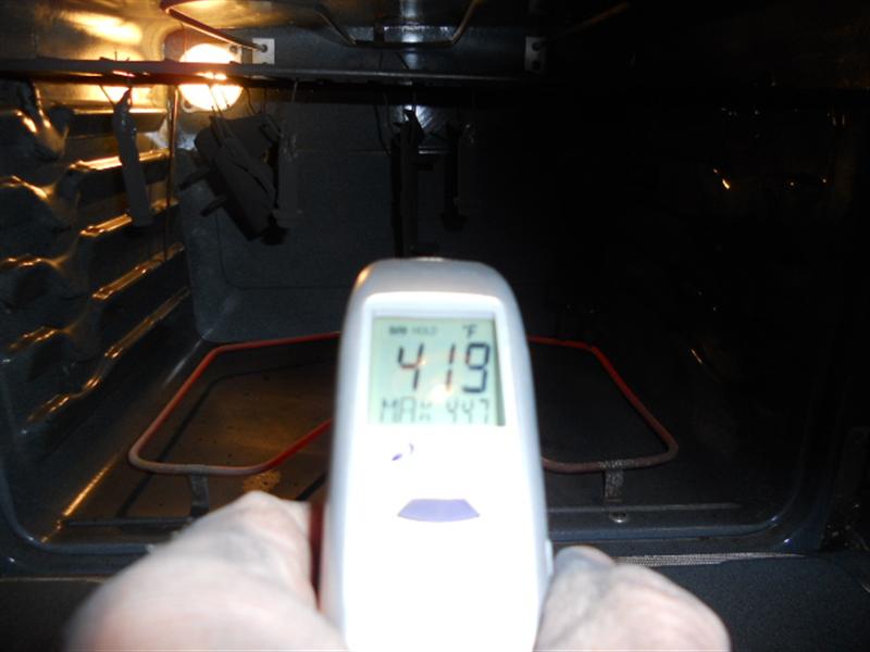

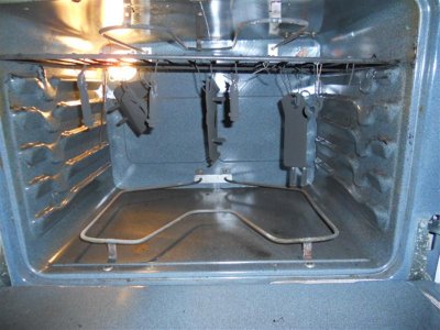

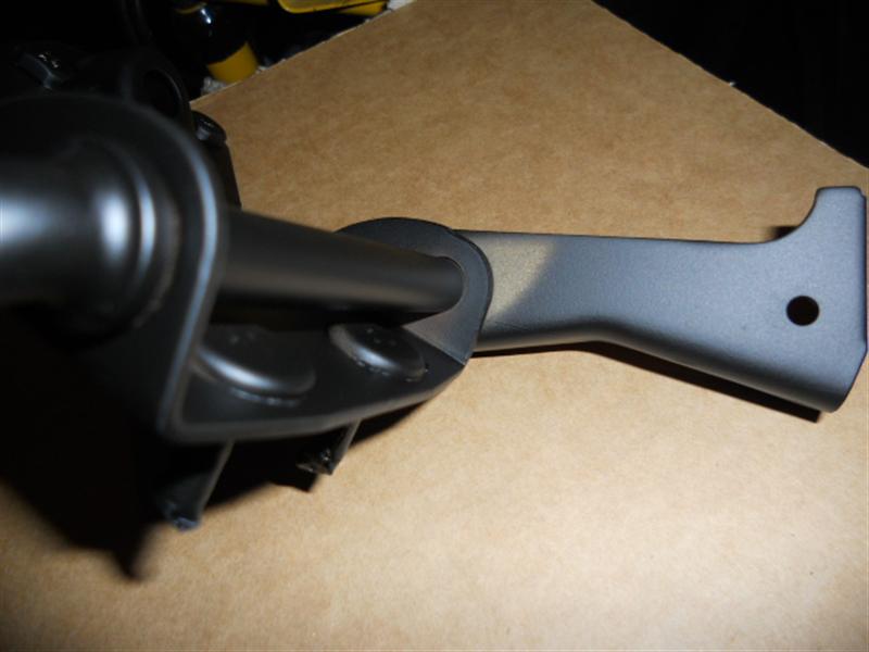

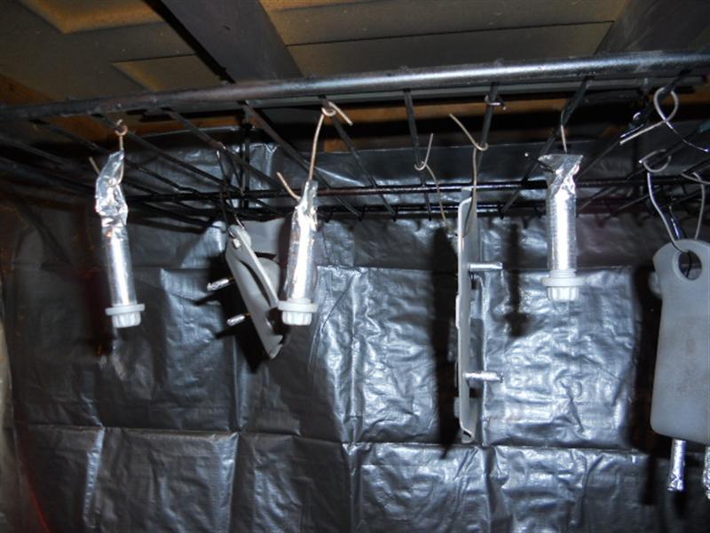

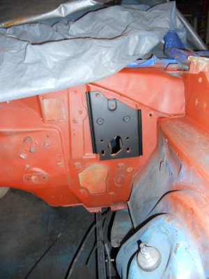

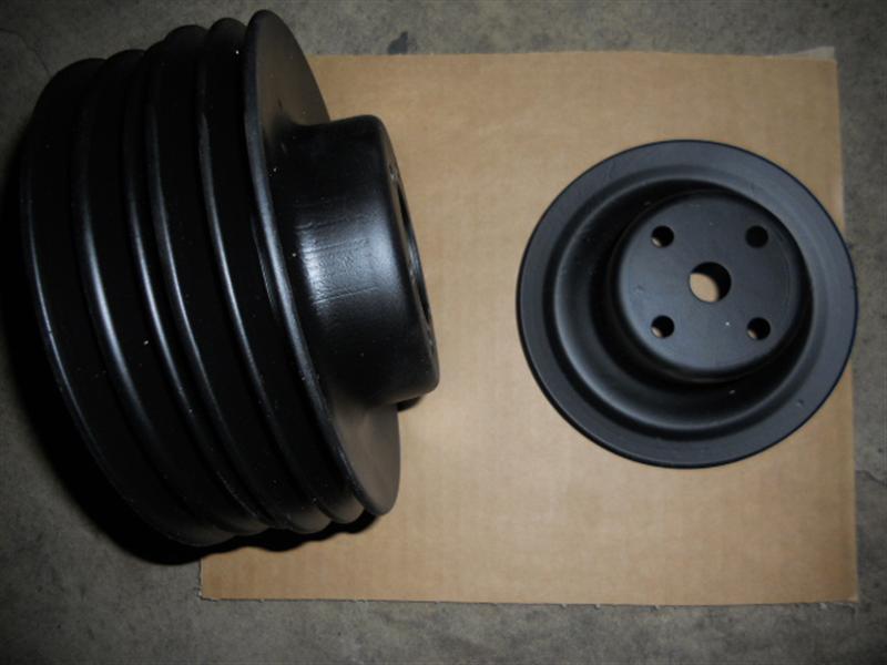

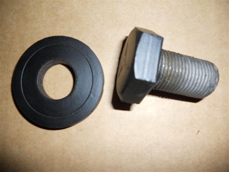

Hey Ron, I'm off on furlough today so had some time to get a few things out of the way and do a little blasting and powdercoating. The powdercoating itself doesn't take as long as the prep, same as painting, but unlike painting, as soon as your parts have cooled off, they are ready to re-install.
Before the peanut gallery chimes in, I know these are not the "correct" finish colors if you were to be doing a "factory correct" restoration. You can get different color powders to get a more "correct" color, but this works for my taste.
You will want to keep the powder from getting on/in threads as the powder does build up thickness. I tape or put a tape plug on threads and will run a tap or die over them before I install. You will see in the pic of the gas pedal bracket a spot that didn't get coated after it was applied , no problem, just rehang the part with the exposed area showing and give it another coat.
Clean up is simple, just sweep or vacumm up the residual powder and your done!
Powders are readily available, I use the Matte Black from Harbour Frieght for a lot of what I do.
The finish is superior to paint IMO as it will not scratch easily. Brake fluid won't harm the finish either.

Guys, please avoid those UV lamps if you can. They result in extremely uneven temperatures which cause improper curing, especially on large parts. Save your money and get a big oven somehow if you want to expand to bumpers, rear ends and dash frames.
Though it isn't much, you can instantly gain a little more room out of your oven -- up to a few inches -- if you remove the interior panel that covers the door insulation and get it out of there. Before I built my seven-foot batch oven, I lost jobs over a mere inch and a half! I've been there so I know what you're going through.
68Sport, it's a little tough to tell from your photos but I'm going to say this anyhow. A really good practice to get into is not using the same oven rack to cure as you do to shoot your powders on. Shoot on one rack and then transfer the parts to a clean one. Unless you blast them and your jigs clean after every cure, what will eventually happen over time is that the overspray will build up on the rack. Then, every time you use it, that old overspray continues to cure, becomes brittle, flakes off and falls all over your parts ... probably just about the time it's starting to flow out.
