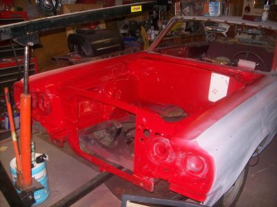

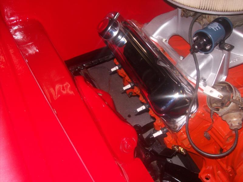

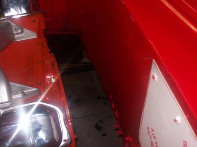

firewall
I removed firewall and ended up with this much room. hope this helps.
