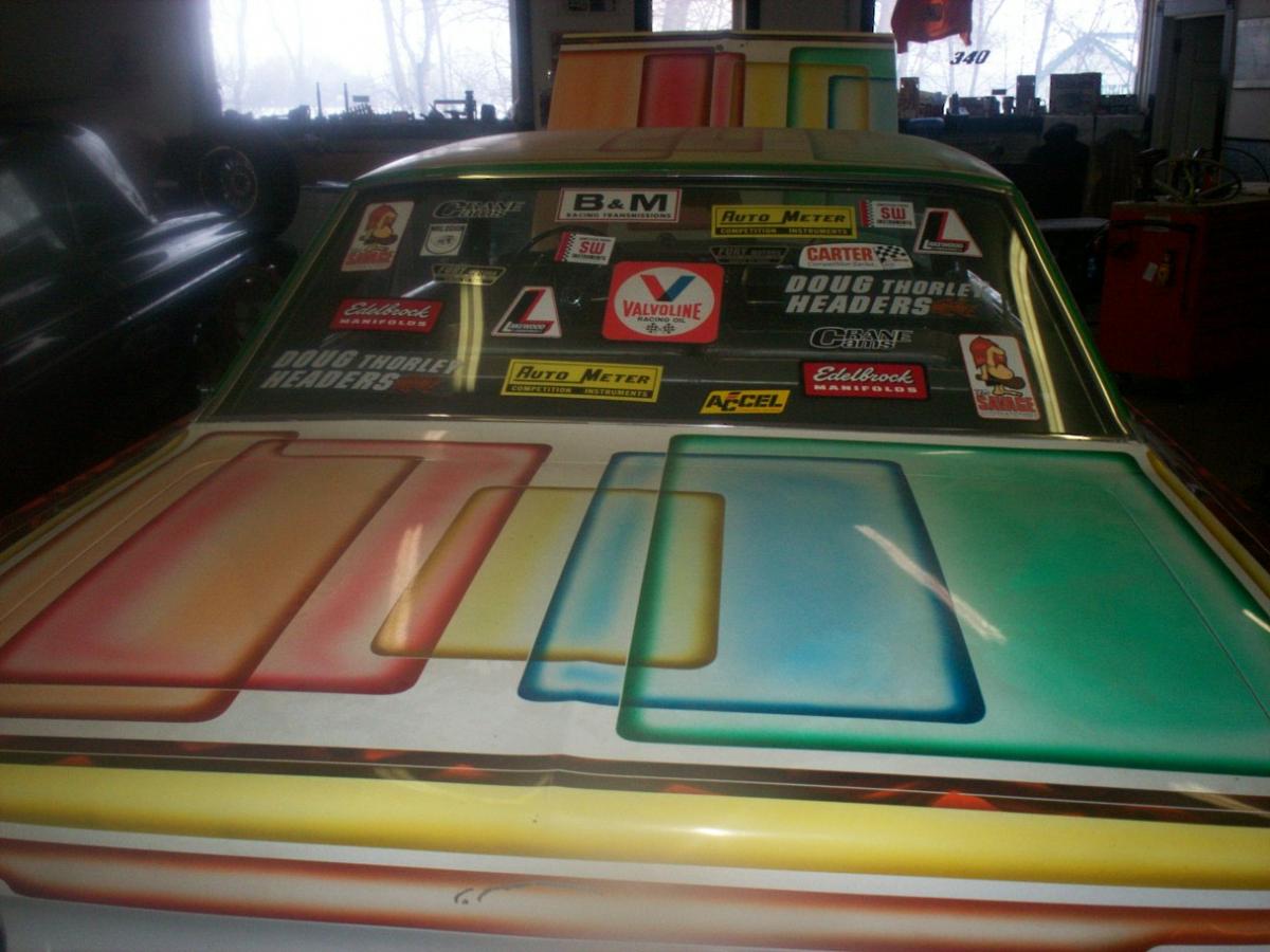

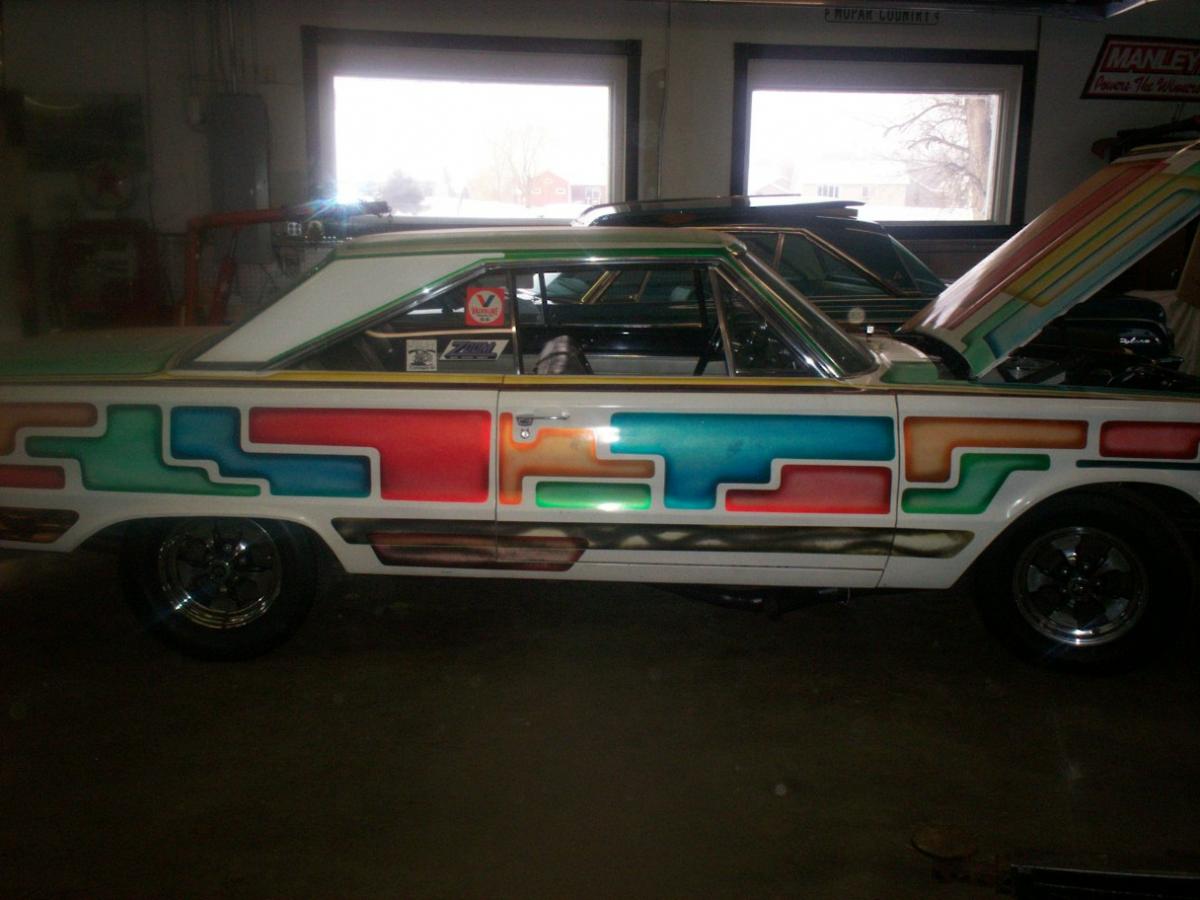

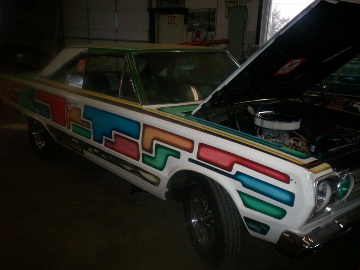

It would have been Minn Dragways, Twin City Speedway or Amber Green in the late 60's through early 70's. It was a barn find, parked since 73. Trying to get a little history about the owner/driver. His nick name was "Moose".

That sure is colorful, Really like the paint jobs people did back then. Sorry i'm not any help since i wasn't even born til late 91' lol. Hopefully someone around here has seen it, Looks like alot of fun. Did the owner remember what it used to run?

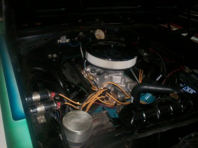

Can anyone explain the 2 coils for me?

Thats a cool paint scheme...I like the body style too..
Petty Blue 67 GTX

It's an early Displacement On Demand system. One coil fires 1-4-6-7 cylinders and the other coil fires 8-3-5-2. To save gas when cruising to the track you simply switch off one coil.
That paint job looks like it was done by Greg of Akron. He is the one who did all of Arlen Vanke's Cars. He also did the original paint job on Dad's car. The guy was incredible.
Is there anywhere on the car where the pinter signed it Greg of Akron?

The car showed up with no engine and Firestone 500's mounted on 6" Keystone's in the back and those truck tubes still held air all those years. Found out the 18 spline 4 speed was a Liberty built 833 crash box which was then rebuilt with full syncro's. Still had the fenderwell headers which are back in the car after being ceramic coated black. (He's gonna half to make some wide left hand turns.) Swapped out the 5.13's with 3.55's and put a mild built, pump gas friendly 428hp/400 in her. There was a distributor cap in the trunk that was for a DuCoil distributor. The oringinal distributor wasn't there so I rebuilt a point's distributor with a Petronics kit, used a tan Accel distributor cap with the vent plug and hooked the dummy coil and coil wire to the vent plug in the cap. Give's it the old school look and yes, figured there would be questions about the 2 coil setup.

This makes no sense to me.
So if I get this right, You click off 1 coil and just run on 4 cylinders on a 8 cylinder car.
I really cant see the car running at all on 4 cylinders and the fuel would foul out the sparkplugs since its a carb. setup and dumping fuel when depressing the gas pedal.
Maybe I'm missing something here. But I cant see this working.
Also if theres only 1 coil wire hole in the distributor cap ,how do you fit 2 coil wires into 1 hole? :confused:
i think thats how it is now, the wire is just put there for show .... the ignition has been changed ........ but i agree with you, how the hell did that work ???

Um, dude, I was just kidding. I really had no idea why there are two coils, so I just made something up. My other choice was saying that it was wired to the starter to double the ignition voltage for starting a high compression engine.
They used to run two coils to give a hotter spark to the plugs. Same theory as an MSD box. Usally just made the points burn up quicker, Was not a popular setup, I think it was Mallory or Accell that had a kit availible.
