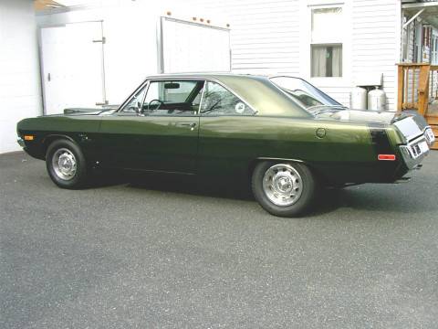

We have a stock stroke 400 in my sons Dart you see here with Eddy RPM heads. He uses the MP .557 solid cam and Crane ductile iron rockers. Its a mild street car and it has KB pistons with 10.6 comp. RPM intake and a 750 DP. Body is all stock and we installed a 6 point rollbar and frame connectors. Has 3.91's and a 9.5 Dynamic converter. Weighs 3550 with him in it and has run a best of 11.45 @ 117. I only told you of this as a 400 is basically a bored 383. I cant say how much the heads would have picked up over 906's but I will say they are definetly better performance wise then the 906's even with some port work done on the 906's. Ron
