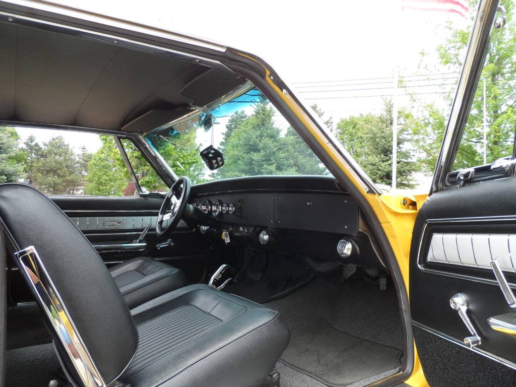

I use a Hurst Quarter stick. I quite like it. I wrapped the cable with header wrap then 3M duct foil tape. The good stuff. Doesn’t look pretty but works great. Throw is good. Adjust cable for 3rd if it’s a reverse valve body like mine. No issues. Never missed a shift.
Pistol grip or ball?
Ball. I got a different ball with the button on the side instead of the top. More comfortable.
