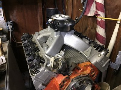

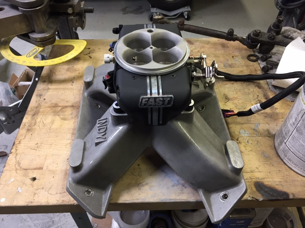

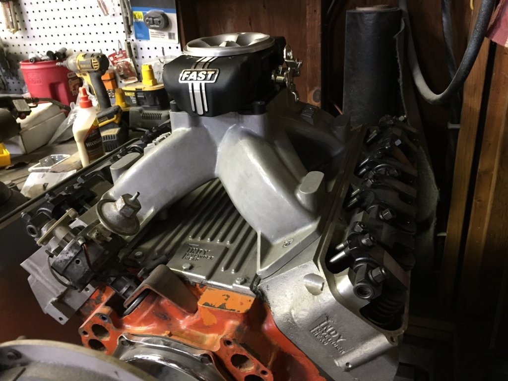

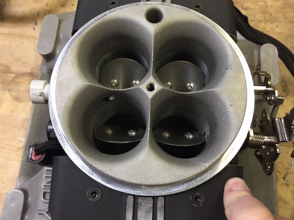

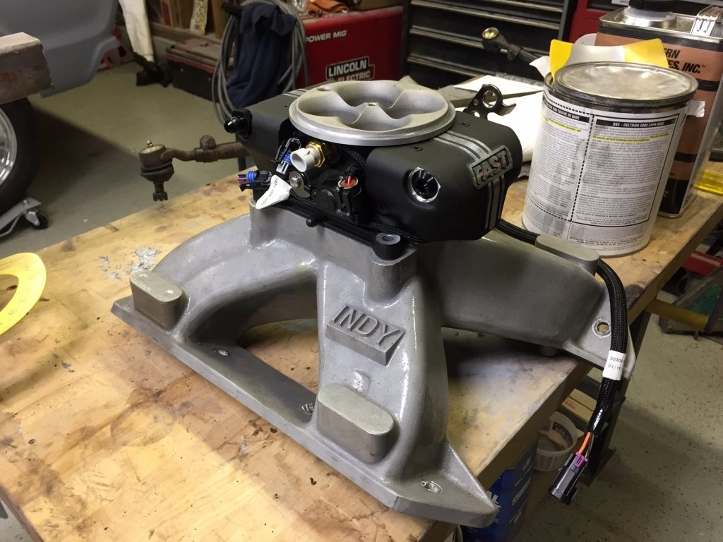

F.A.S.T Sportsman XFI for me. Suposed to be good for 1200Hp NA and has NO2 compensation. Also running their distributor. My motor is kinda radical, Ported Indy -1 heads, .278/.281 @ .050 - .681/.660 Lift solid roller, Indy single plane. I will drive this on the street and the reason I went FI..
