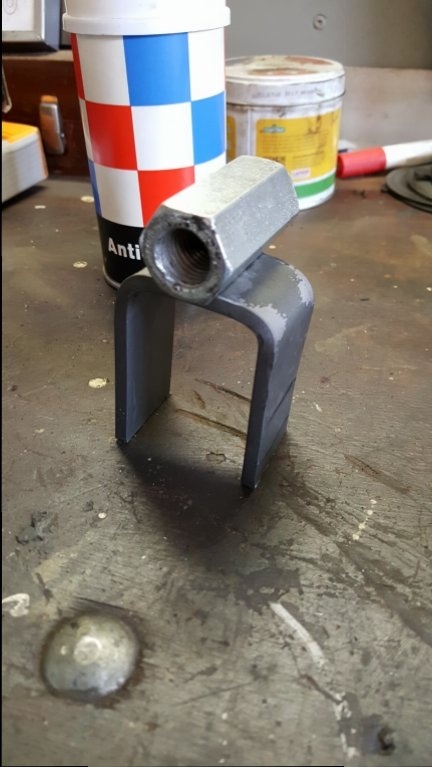

I'm installing koni's as well. My bushings were to small too. I made em slightly bigger with a grinder.
But I ran into another issue with them. They are too short. I had to make an extension bracket to make em fit.
Antoon
Antoon

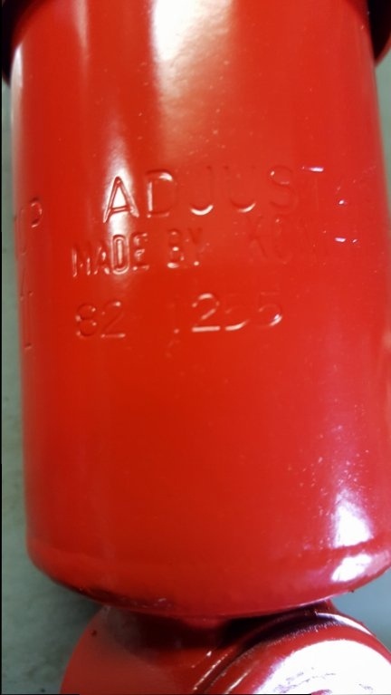

Same part number shocks?
-Kurt
Yes same part number. 82-1255. They are about 2" shorter than the kyb's I had installed.
Kyb's are a cheap shock and that is what you get. They do the job but are in no way a good shock absorber like koni or bilstein.
