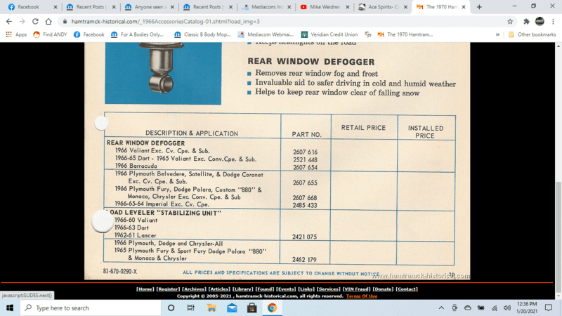

Available as a accessory for sure. Out of the 1966 accessory catalog.

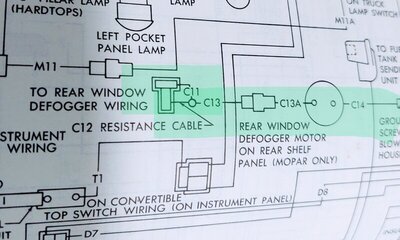

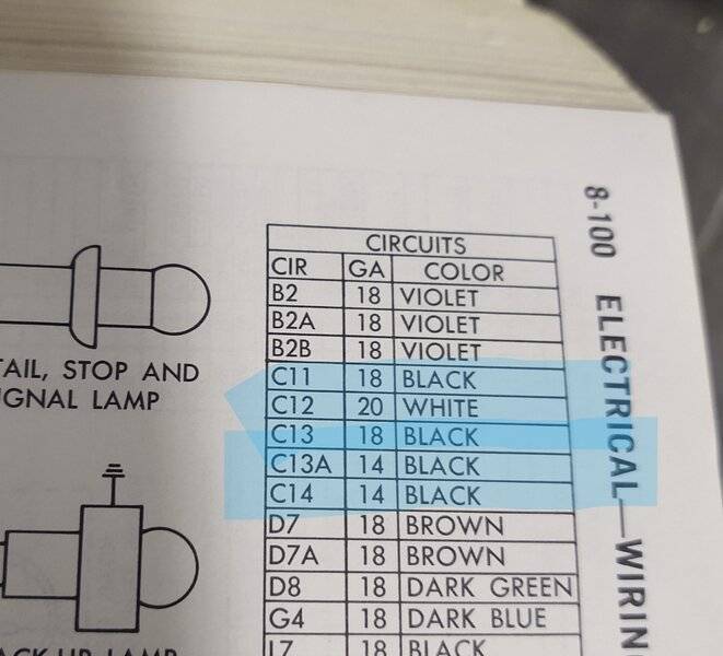

I'm not sure how much help this will be, but this is a wiring diagram from a '66 Dodge manual. On the instrument panel diagram, it shows an unlabeled wire coming off the third (from left) fuse in the fuse box, to the "rear window defroster switch". That's it.
As for the terminal end, here's a couple pictures from the manual:
And after really looking at the wiring diagram, that accessory is labeled (MOPAR only). I've never noticed that labeling before, so maybe, as stated above, it was an accessory that the owner could add/have added through MOPAR? I don't know. Now I need some schooling...

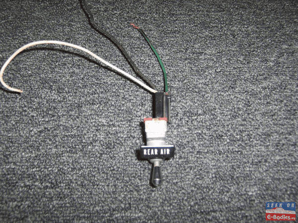

Usually like this: Often positioned to the left of the base of the column
The switch above is not for a 66-67 Plymouth Belvedere or Satellite.

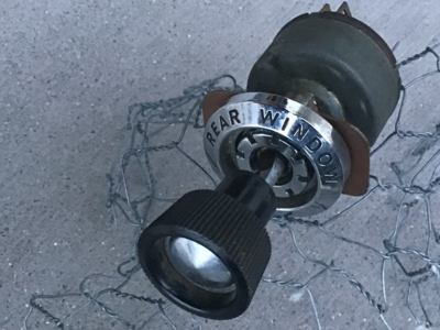

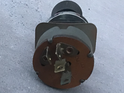

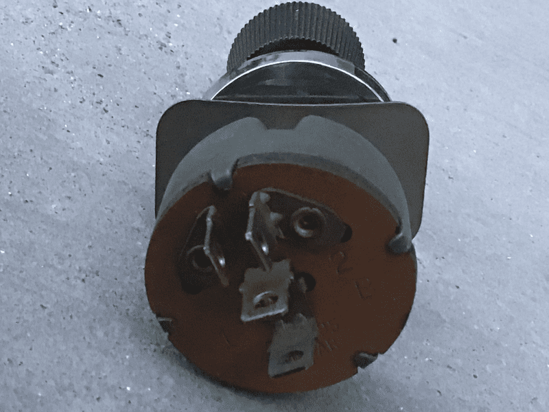

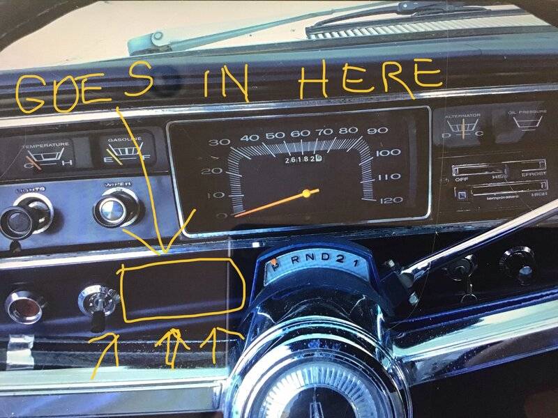

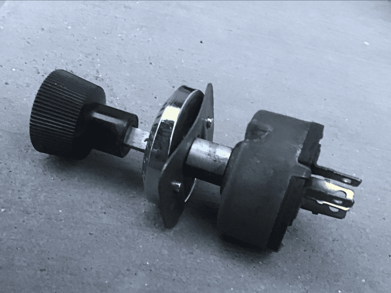

The factory switch gets in the lower dash metal and has a chrome bezel and knob that matches the others on the dash. Like the lighter and ignition switch. It has off/low/high positions.

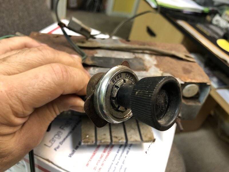

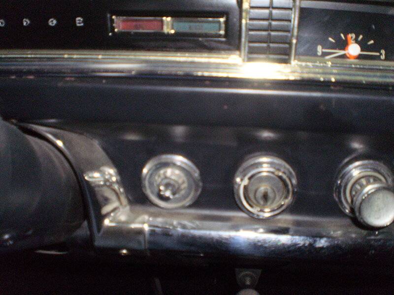

My 1967 R/T has rear defrost. The package tray cardboard has holes for left and right speakers punched in it. The rear speaker mounts under the left side. The defrost air intake mounts under the right side and blows air to the rear window through a long thin vent that matches curve of rear glass. The control switch is a OFF, LOW, HIGH toggle that mounts to the dash, right of the steering wheel, next to ignition switch. An emergency flasher switch mounts to the left of the steering wheel. 1967's had factory emergency flashers, but 1966 did not.
That definitely looks like it belongs in a 66. Guess someone got the bright idea of sticking one in the trunk of my car but never got around to installing the rest of it.
The motor and duct can come from many different cars, the 66-67 Plymouth specific switch is hard to find. So is the Dodge switch, the knobs and bezels are different Plymouth to Dodge, but the switch might be the same.
The more generic toggle switch In post #8 came in many early 70’s darts and will work to operate one in a retrofit.
Switch looks similar to a 67 rear speaker control.
