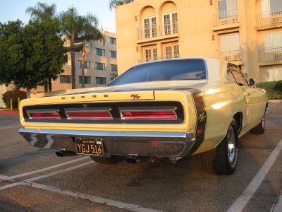

Summit. Inexpensive truck leaf - one each side. Modified length, gave about one inch. Just right to allow for the beer and passengers.
