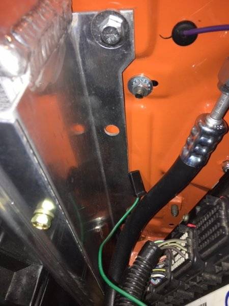

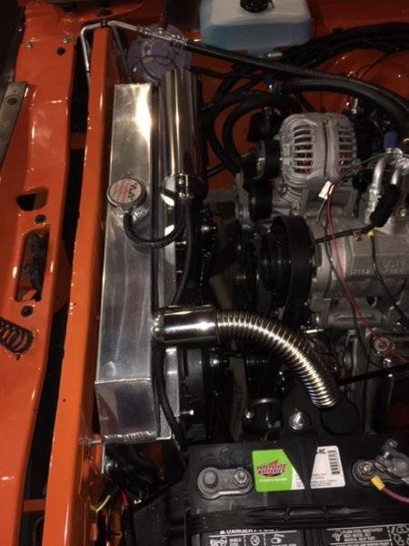

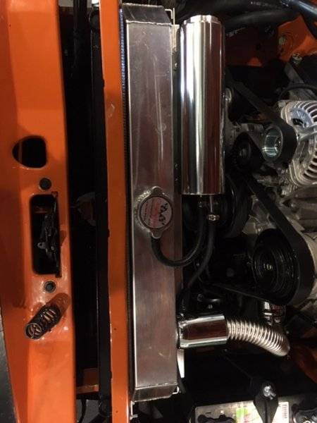

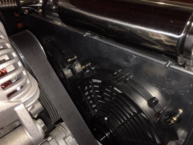

Don't know how mind cools yet - haven't started it. The Champion Radiator installed OK - seems like I had to drill a hole or two. My engine compartment was getting full and I had no place to put a catch can (wanted to use an old whiskey bottle). I riveted a catch can on my fan housing which is a duel fan setup. Also set up the fan relay to come on when the AC is turn on, or a block temp switch when the motor gets hot, or via a toggle switch under the dash - all are ground activated. It's full of antifreeze and not leaking yet.
