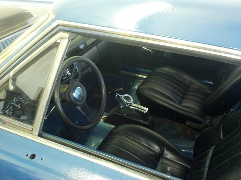

Recently purchased a 70 RR with Bucket seats.....was wondering if anyone has replaced their stock buckets seats with any other type of used OEM seats? If so please reply with photos.......

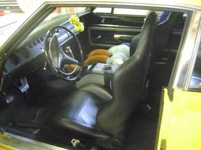

Summit racing buckets.

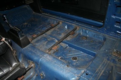

My 69 belvedere came with seats that are some other OEM, but i have no idea what. Closest thing I've seen, believe it or not, are Volkswagon beetle seats. Theyre comfortable and pretty lightweight, less than 20lbs each.
Of course, instead if fabbing brackets, the PO welded these big ol bars in. Makes fitting a carpet hell...

That frame rail going through the floor pan isn't going to help with carpet installation either. :)
