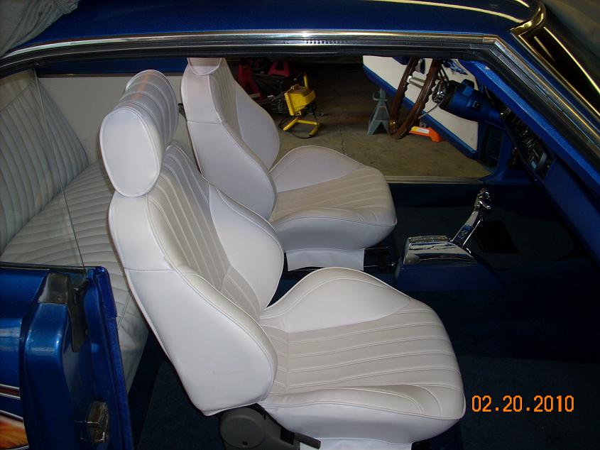

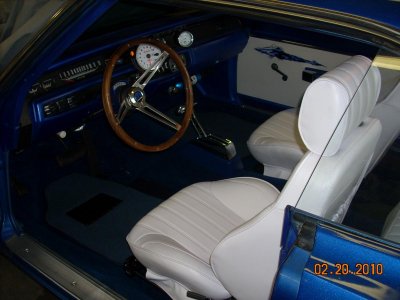

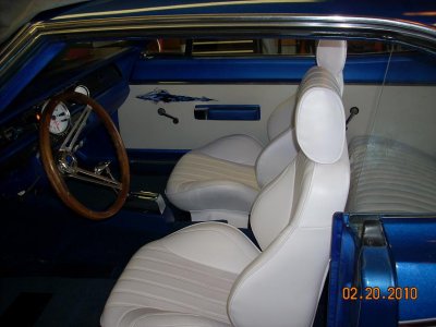

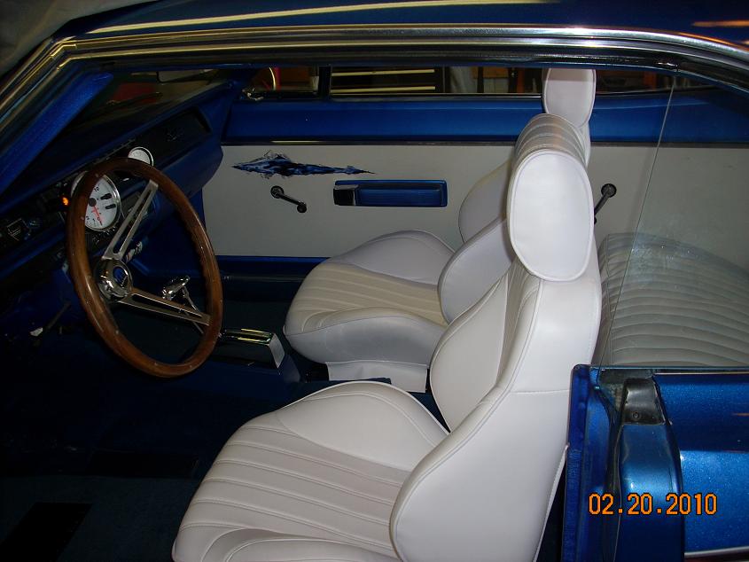

I have the Procar 1000 (rally) seats in my 68 Sat. They fit very well and I am 6'2" and have plenty of room. I get compliments on the seats quite a bit. I used the brackets that Procar sells. Like most guys, I figured "won't need'em". But they are made for the Procar seat mount and will make installing them much simpler.

This particular seat sits pretty low. It has the side bolsters that are a littled taller than the seat base. The seat bottom at the front is only about 7 inches from the floor with the seat brackets mounted in the highest position. The seat bottom sits very close to the floor. The bench I took out , now, talk about tall. My head would just touch the head liner. As to the brackets. The seats use a verticle mount, not an "L" shaped bracket and mount 90 degress to the seat bracket and are adjustable as to up, down, front back up and down. I would HIGHLY recommend them.

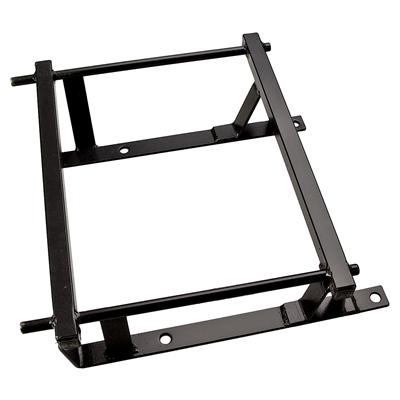

Here is a photo of the bracket for the 66 to 73 B Body as sold by Summit. The bracket bolts to the floor and the seat bolts thru the vertical braket on the seat into the rod shaped pieces running fore and aft. My cars in the trailer for the season so it may be a little bit before I can get some pics.

The brackets I got thru Summit looked something like those........and they still look to be too tall. I am assuming that they do not use the stock bolt holes in the floor pan? The ones I had did not and that was another sore spot. My car originally came with a bench seat, fellow I bought it from had some buckets from an E body car in it at one time and I kind of balked at drilling any more holes in the floors. I have a set of stock bucket seats but they need everything......foam, covers, and new plastic backs. Expen$ive.
