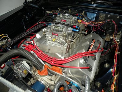

Does anyone know what the primary and secondary jet sizes are out of the box for a 800?

Right now I am at 104's in the primarys and stock in the secondarys. We had a unajustable rich condition that was fixes by getting down to those jets and different rods still tweaking it but at least we can use the a/f mix screws to make adjustments. Have a little lean condition now but can fix it with one size up. When we took the carb apart we found one of the floats flat on the deck. Little things you don't know until you tear inyo them.
I would bet your metering rod springs are too stiff- 104 is awful lean on those
Seems so huh...we tried every combo with the jets until we got down to those and could tune then jumped back up to 104's. it is at the softest meter rod spring now i am going to try one size up spring and rod see what happens. I keep wanting to jump up to the 107's but we had tried that and lost the A/F tuning ability so now it's down to A/F screw turns and rod / spring changes for now see what happens. Funny how this carb came out of the box with the largest and highest of everything. like race ready good thing I guess if your revving to 4 grand and launching lol was not tunable out of the box.

Nice read and that test make sense. I changed from the lightest blue spring to the next size up which is yellow and jumped up to the 7047 rod size took her out last nigh and the idle seemed better but hard to get a large cam with mech advance distrib to idle in drive. I have the stock stall converter in the 727 so right now I think I have all I can get out of it until I change the converter out to at least a 1500 then the fine tune points will start to seem more effective I think.
about 12-15 initial and around 40 total, trust me the timing thing is in a whole other thread about the 440source distrib I bought! Chinese crap. Cam is the comp cam extreme energy 23-710-9 instead of me typing this all out just look at the picture lol
14-16 idle and around 36 total would probably work a bit better, but it is going to be hard to tune this combo with a stock converter
