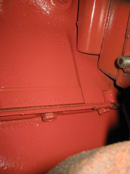

My lovely soon to be ex-wife wants a share of my Coronets value and the appraiser came out yesterday to inspect my cars. He claims that the vin stamping on my 1969 Mr. Norms Coronet Super Bee engine block and radiator support are somewhat crooked and look possibly faked to pass it off as numbers matching. Also, he claimed the leaf sprig torque box is not welded (?) like all Super Bee's should be. This is a 383 four speed. I had it appraised 5-7 years ago and it was by a professional appraiser that only worked on Mopars and had a 1968 Coronet R/T and he never mentioned any of the things the new appraiser mentioned. The more the new guy is incorrect about it authenticity is better for me as it would lower the value of the Super Bee in the marital assets proceedings. Is he correct about the torque box and vin stamping? Thanks guys

Thanks hunt2elk. Does the vin stamping slightly crooked from each other make any sense?
Yes. Not all stampings were 'perfect'.

Since this is a 69 and I haven't seen a picture of the stamping....
Are the typical milling hash marks still present? Point that out.
Show the inspector the pic of the GTX (RS stamping) and ask them if they would be more comfortable with yours looking like the picture. (FWIW..it's a bad restamp)

VIN’s - They can be crooked as heck, transposed, forgotten, missing numbers.
This self proclaimed ‘mopar’ appraiser doesn’t know ****. Play stupid, let him call it fake if wants, give that to your ex and be done with it. Then if it matters to you and you need to, just have it redone in the future by a better appraiser.
