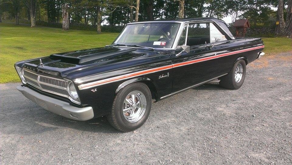

Are 63 plymouth belvedere rear bumpers the same as for the 1965 plymouth belvedere ? I need bumpers for my 65 Bel II. Anyone know if they are the same as a 63 Bel ? Also, can someone point me in the right direction as to where I can find rear & front chrome bumpers for my 65 that won't break the bank ? Any help is appreciated. I currently have fiberglass bumpers on it . Thanks, John

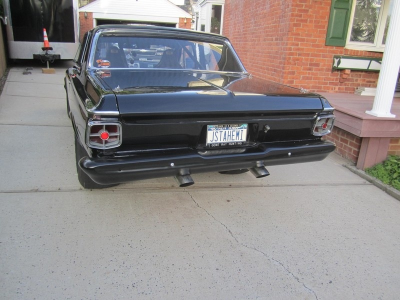

Went through all that a while back. Yes, pretty sure 63 and 65 rears are the same. Main thing is the bolt hole spacing on each side, 63 and 65 the same.
64 rear is different, hole spacing. Mounting brackets between 63, 65 (same)...and 64 are dif, too.
yes the 63 rear is the same the front is different it is 65 only
