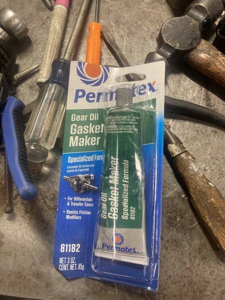

On my last rebuild I got gaskets from Brewers and followed their instructions to install them dry. The front bearing retainer and screws I used a green (Permatex or loctite can’t remember) specifically for gear oil. All new seals and it is dry as a bone.

FYI
