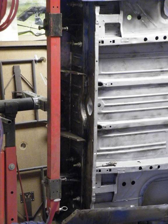

do only the 71-74 BB cars have torsion boxes ? or is it only 440 cars ? or do they all have reinforceing gussets ?

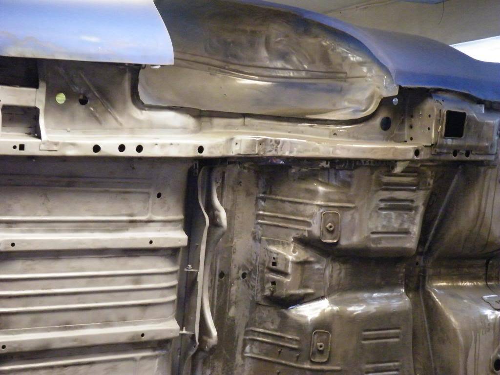

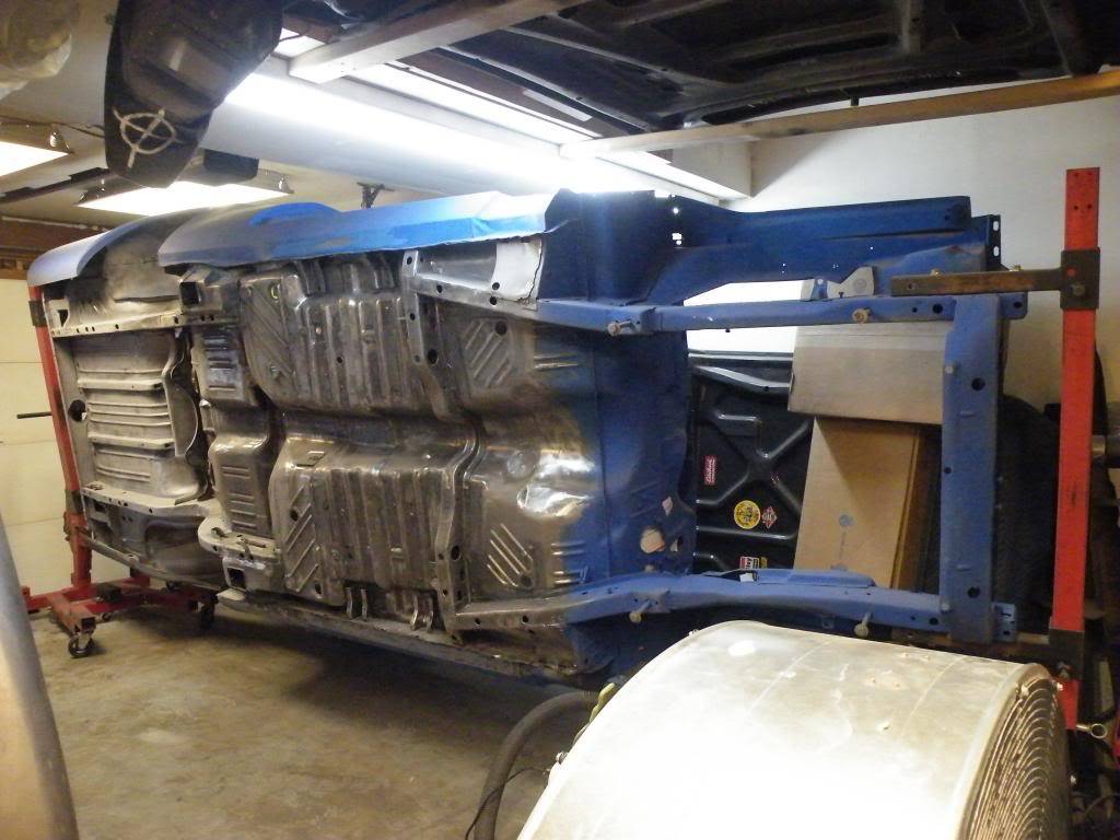

here are a a few pics of my 73 rr / GTX uni body frame
All ragtops both SB and BB should have them.
440HP and Hemi cars should have them.
I have see some SB cars with either fronts or rears on them.
383 cars usually didn't not have them.
