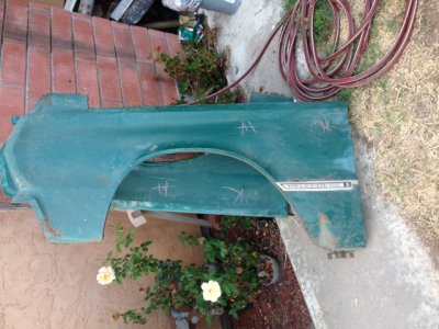

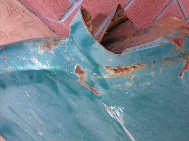

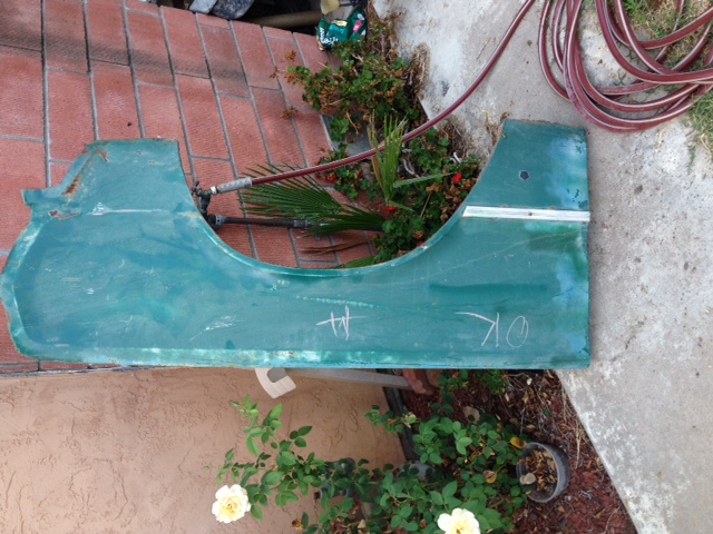

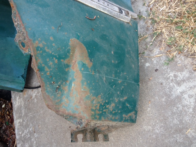

I just picked up a fellow B-body members 67 GTX.
Two damaged front fenders.."patch panel work needed"
I found 2 Belvedere I fenders.
Are they the same as Belvedere II and GTX fenders?
Except for the "Badging"
Pics are the Belvedere I fenders I have a chance to purchase Saturday:
Only difference is trim holes. Physically, they are identical.
Make sure they are of the same year you are putting them on. Headlight sockets are not the same 66 to 67.
