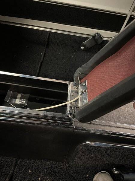

Replaced my drivers armrest with a decent one, where does the white cord attach to on the lid- my old one was missing and I think they may have upholstered over it...picture a would be nice. Thank you.

I think you are correct. There will be a hole on the drivers side of the door, behind the vinyl. It will be on the vertical frame, screws in from the inside.
