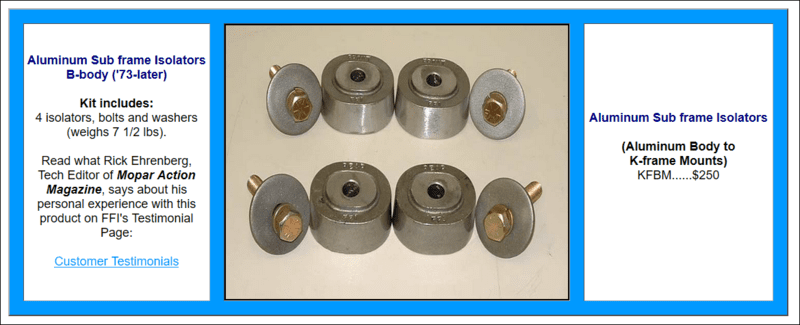

The front subframe on the 73+ cars is pretty stout. You should go with solid k-frame biscuits at the HP level. I would also use solid spacers for the torsion cross member. Rear axle mounts can be swapped to the earlier style.

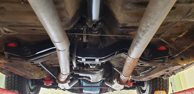

On the 73 and later the torsion bars pass through the crossmember and mount to the isolated mount behind the crossmember. This is a pic of the underside of my 73. You can see how the isolated mount will be in the way of the frame connector. It will take a little work to get the frame connector around the isolator.
As mentioned previouslly... hence the reason why most of aftermarket parts manufecturers don't offer connectors for 73 and lates...
Could it be made diagonally? Maybe, but the emergency brake lines and parts will be in the middle too
