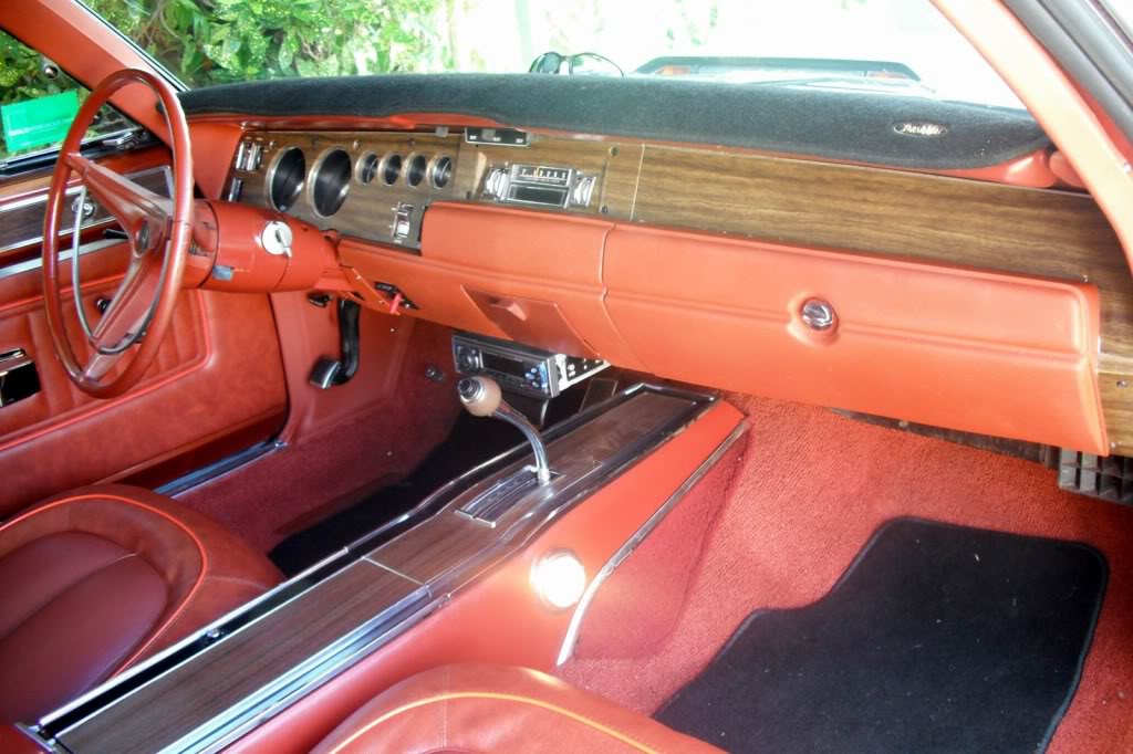

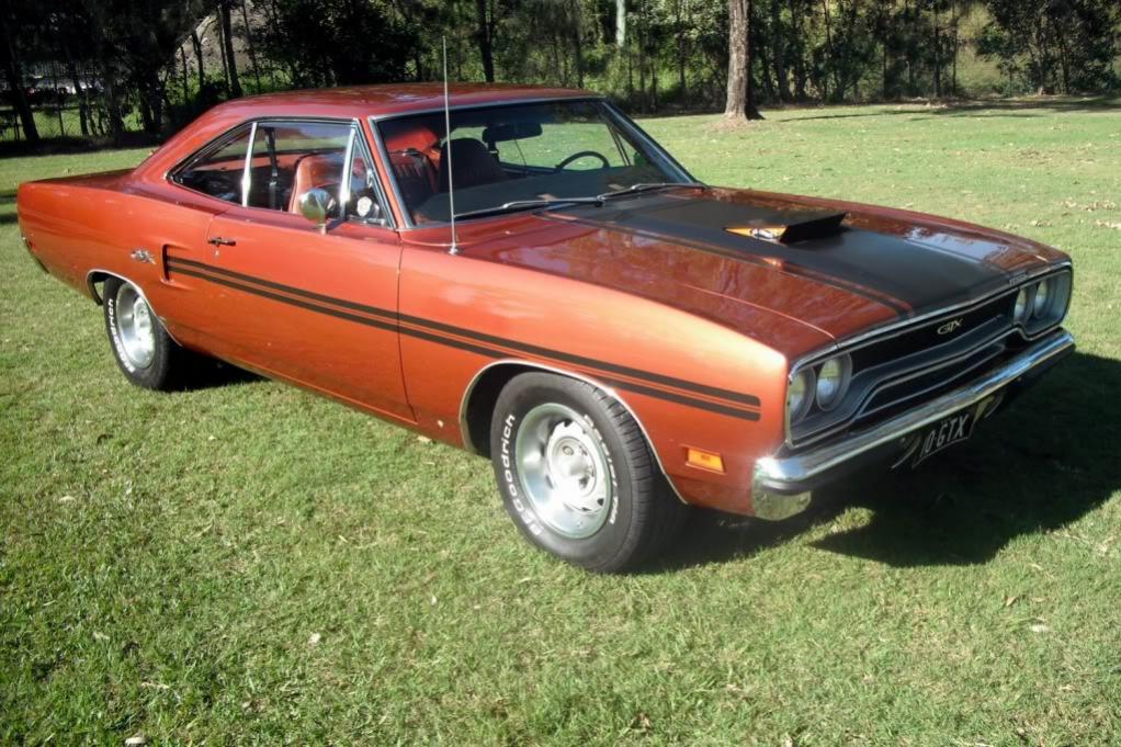

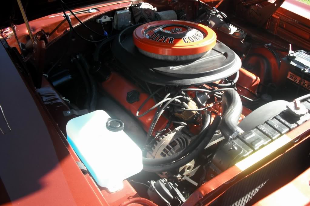

coupla pix of my X.... Im the 3rd owner,[ 2nd from 86!],I bought it at the 2010 Fling, mostly orig, just detailing it here n there. Ive just swapped out the 4BBL for a repop 6Barrell kit, fitted a nice woodrim wheel,resto plug wires etc .
Runs its orig NM 440-4 is an orig 3.55 geared car and has a A518 in it that was fitted in '96 [ see the install in Car Craft magazine in a 96 Art Carr feature!] Soon to fit a 3.91 Truetrack .

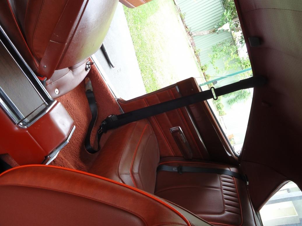

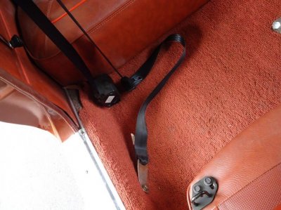

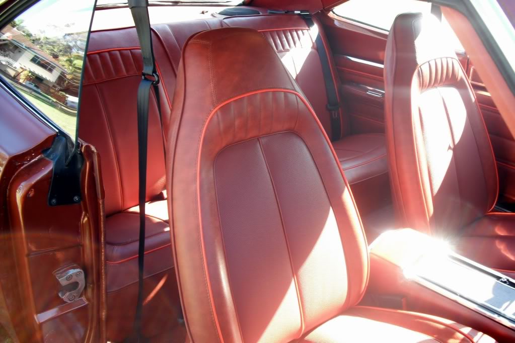

I notice that it has 3 point shoulder belts both front and rear - they are obviously aftermarket.
Do you mind posting some pictures of the attachment points for the retractors (behind the front seats and for the rear belts). I added modern seat belts to my Son's 73 Roadrunner, and I am curious how these fit.
Thanks in advance!

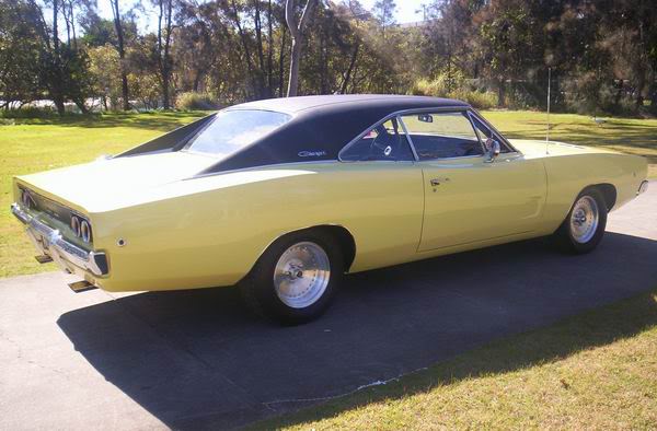

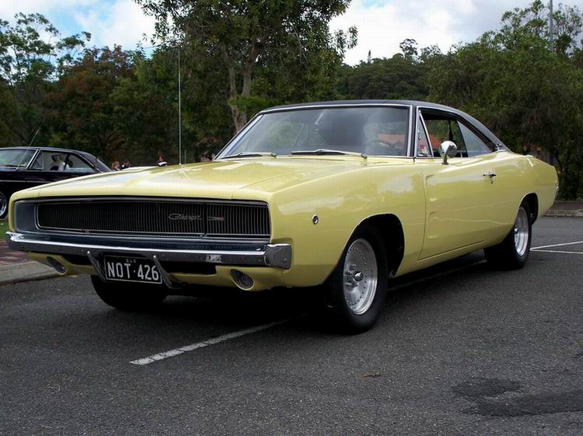

My old H code 68 Charger

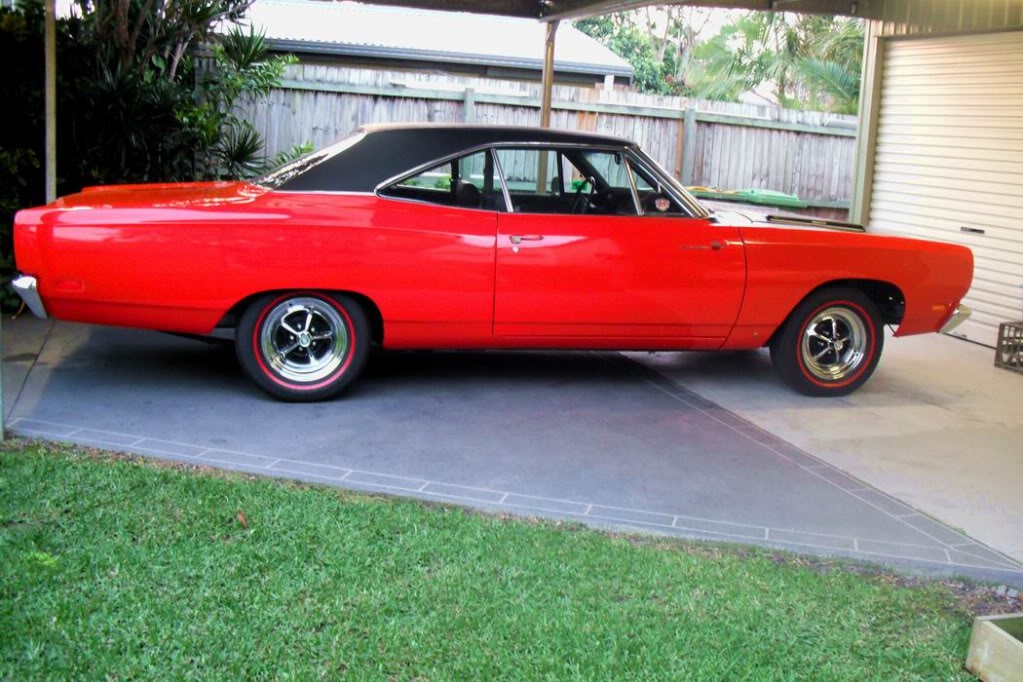

69 runner

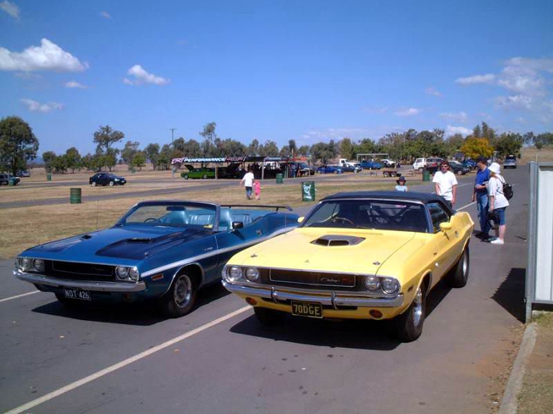

my old blue 70 Chall vert [ notice anything 'weird about the 2 verts?]

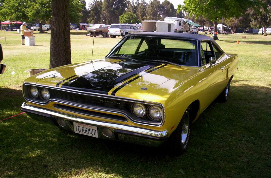

My old 70 runner at the 2009 Spring Fling

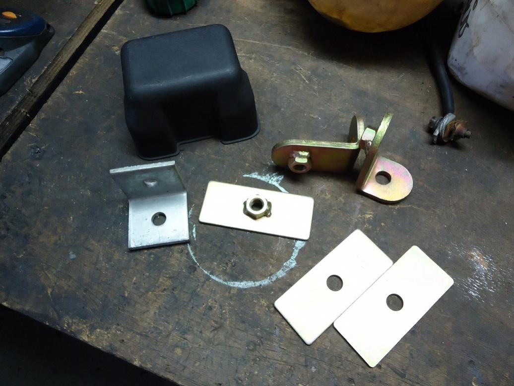

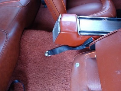

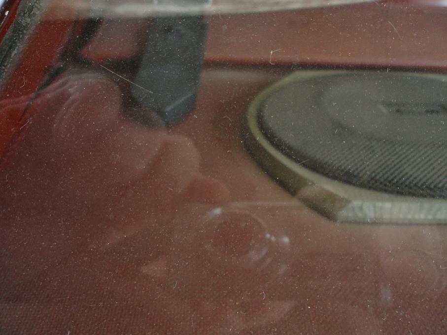

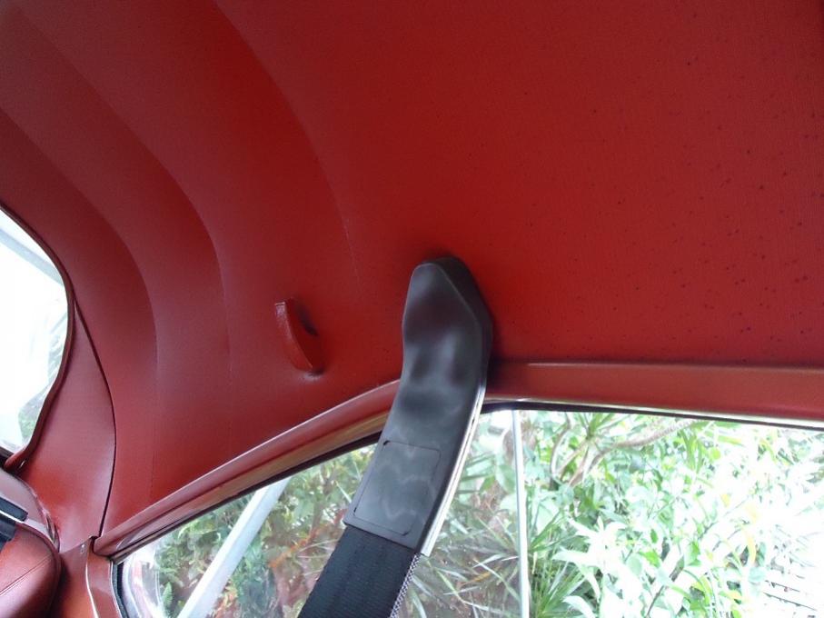

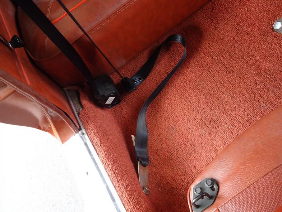

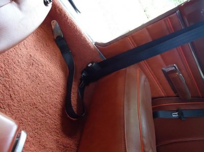

Hers some pix for you Hawk..

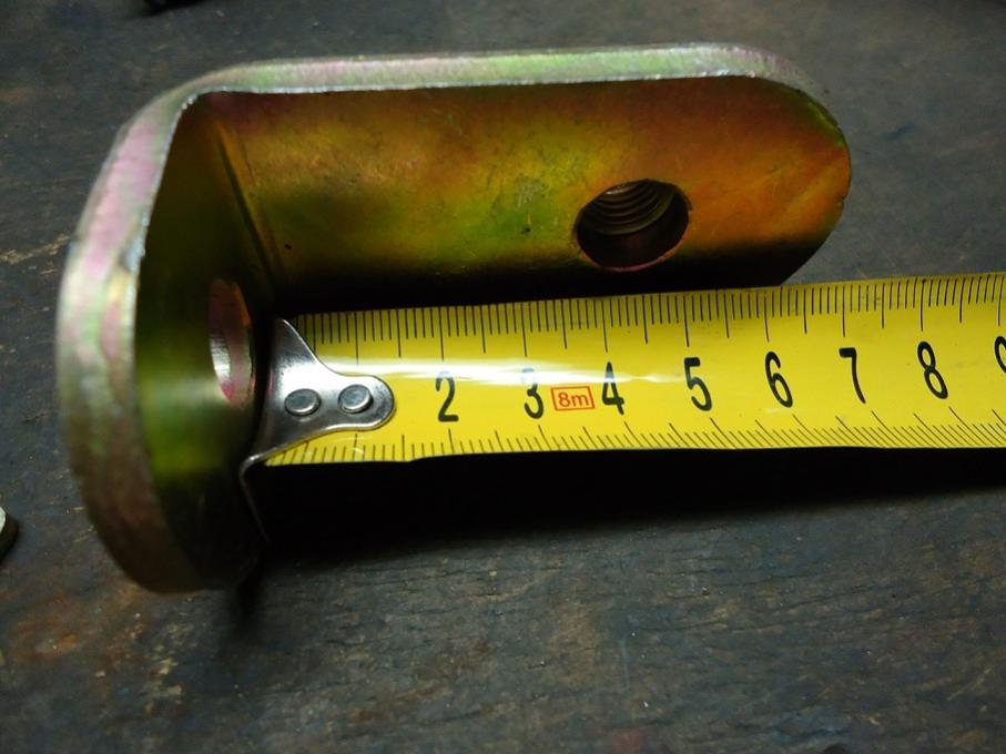

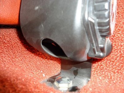

For the retractor, I once would weld up a short bracket with a fastening nut also welded to it for mounting the retractor. I would then weld this to the floor, near where the radio and rear harness feeds. Making the braket is all done because the retractor must be 90deg and inline with the top mount to work nicely.
Anyways , that was getting too hard[!], so I now use a 90deg bracket, even though this facilitates drilling a hole through the floor to bolt it in. It does save alot of work.
You can see I have made use of the outside front factory bolt to mount the steel end plate. This was fine, but I now use the same bolt for the end plate as the retractor as it keeps the overall look cleaner and makes getting in n out the rear seat less hassle for pax. I also order the belts with a 150mm 'drop', you can see it hanging from the hoodliner that feeds the belt, this eases the uncomfortable shoulder/neck rub
You can use all other factory holes for mounting, eg the orig in the hoodlining and the orig inside fronts. For the rears, there will be 3 or 4 factory pressed 1/4" holes in the parcel tray. I used these as guides and driled a little larger for the rear shoulder belts.
