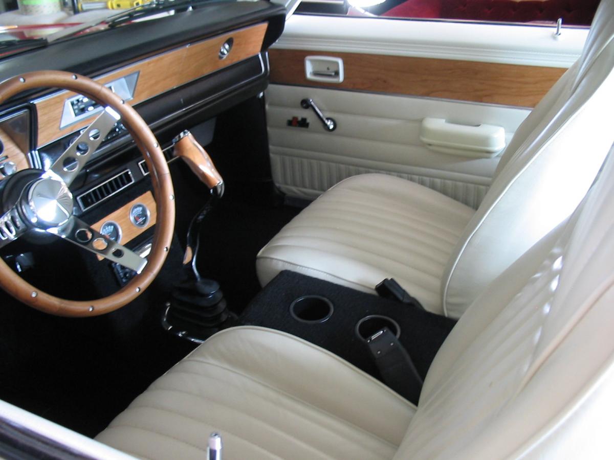

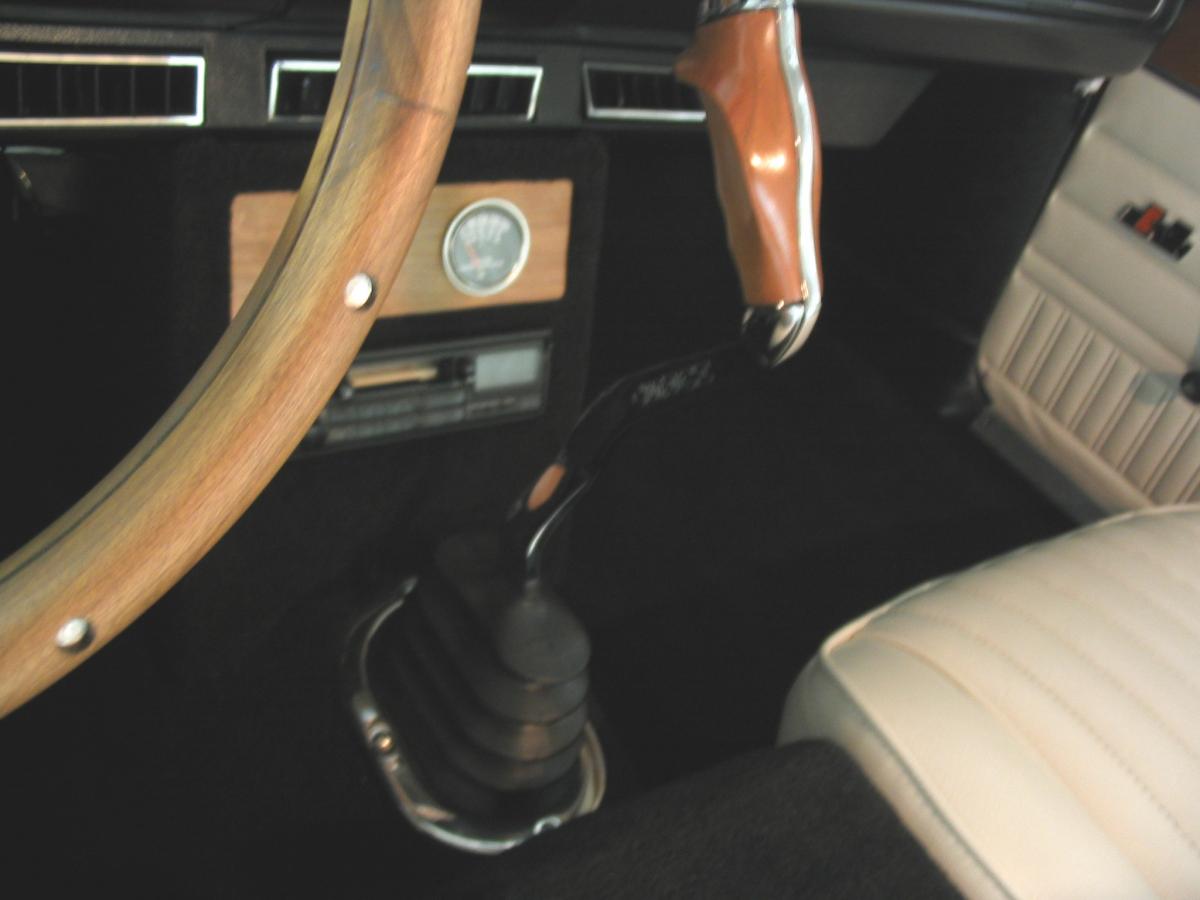

I installed a B&M directly on top of the hump with the extended 6 foot cable they sell.......I believe there would be enough length with that cable if you used a 4 speed hump install......the offset wouldn't be too demanding on the overall length of the cable, according to my memory banks.......:edgy:
Heree's a couple pics of the install directly ON the automatic hump........I had actually thought of welding a 4 speed hump in for it, but decided against it.....it'll work both ways me thinks.

It's simply a Unimatic, cut off and drilled to accept 2 small bolts/lock-nuts to mount the stock Hurst shifter. Looks and works like a dream.
