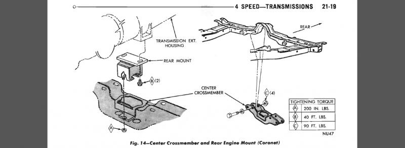

Is the auto transmission crossmember the same as a 4-speed crossmember in a 69 Charger?
I can't find it in the parts manual.
And this is all I could find in the service manual
no, i did not know this ether until i i had them both out. the mount actually sits out board of the cross member an the auto were as the mount sits in the center of the cross member.
When I swapped a 4-speed into my auto 1970 road runner, I used the same crossmember but turned it around backwards and it worked fine.
It is the same cross member, but the auto has this extra bracket on the side to drop the mount in.

You can modify the auto crossmember to work...done it!
The trans crossmember on a 69 is different from a 4-speed to an automatic but as mentioned can be adapted by cutting out the center to let the mount go down in there. In 70 4-speed or automatic are the same crossmember that is providing you are using a 70 4-speed trans if you are using a 69 or earlier 4-speed trans it would be a different one for automatic or 4-speed. There are also differences in the bolt hole size in 70 crossmembers on the body and trans.
