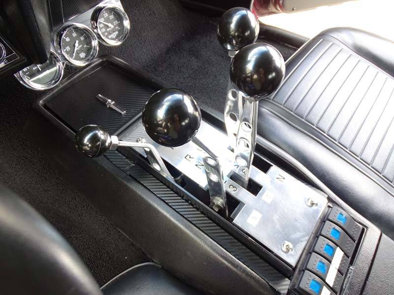

What about something really crazy? Automatic Performance Shifters
I was considering one for my Satellite at one stage. They seem well made and work well, USA made too. Can't see many car thieves taking one on.
Gotta be honest, I don’t even know what I’m looking at in that one
It's not my car, it's a photo off the Kilduff website.
They are a reincarnation of the Hurst Lightning Rod Shifter The Hurst Lightning Rods Shifter System Was The Craziest '80s Transmission Tech Ever Built
They work really simply but look incredibly complex. If you search Youtube there are videos showing how simple the mechanism is. You can't overshift with their system, plus it looks completely mad.
I did make an enquiry a few years back - they aren't that expensive and you can customise them as you want. My son thought I was off my head wanting one, but I just think they are cool.
