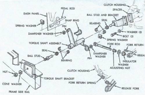

Assuming the bellhousing is for a big block and the trans is a "long tail" for a B or E body yes, it should fit
Yep, the 65 bellhousing is the same as the 69. The main difference between the different years is the Zbar mounting location. 64's are farther back and a different style altogether (mounts with a plate vs the later units with a screw-in ball stud), all the rest are the same.

Also the trans crossmember is different for an auto and 4speed. Other than that you'll need the small parts for the linkage and the clutch / flyweel / pressure plate / throwout bearing / mounting hardware & clutch fork. Not sure on the drive shaft for this vs an auto setup.
I had to buy a lot of my linkage and clutch just like you are doing, just know that the stuff is out there even if it's a little difficult to get shipped to you.

Thanks for the images!
I have a lot of small parts that came with the car when I bought it. Among it is the Z-bar, and a spring. I also have the shifter (with linkages), the boot and ring for the tunnel and the shiftstick (with white ball). I need some small parts for the shifter and a mounting plate (and ofcourse the dustboot for underneath the tunnel).
Furthermore a pilot bushing ofcourse and everything between the engine and the transmission.
Isn't there some bushings I need for the Z-bar mounts?
