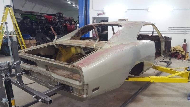

The leaf brackets are fine as long as the arms ar long enough That the rear end of the car can clear the rotisserie. Personally I don't like leaf brackets - I prefer brackets that bolt onto the rear where the bumper brackets attach.
Preferred method ...
Your doing it the right way minimal body distortion..

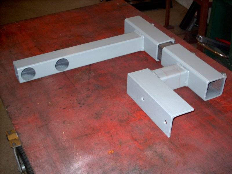

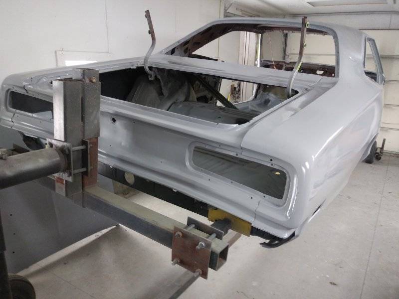

These are front and rears for an early Mopar. You'll want something like the lower one in the photo - with the holes drilled to match those in the valance. You can also make the arms a little longer to give yourself more space to work on the rear but don't overdo it.
