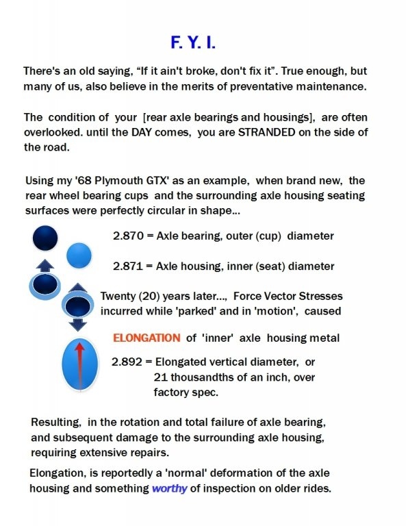

When all is said and done... Have you checked this lately?
