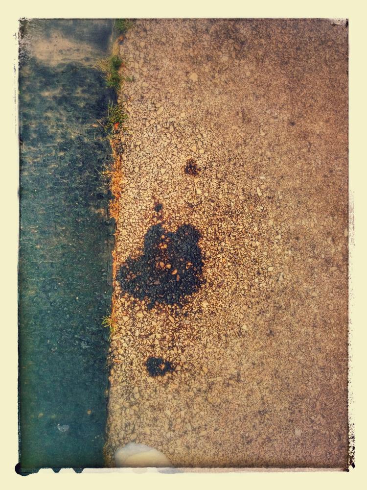

Leak.jpgI need help diagnosing this problem I just noticed. I took my 68 roadrunner out after about a month of sitting in the garage. When I got back, I noticed some oil stains in the driveway where she was parked. The stains were right under the rear axle. It's 3 stains, with the middle one being the largest (right under the diff). I crawled under the diff and the housing has a fluid on it. It looks like used cooking oil. It would make sense that it is gear oil. Any ideas where I can check to see it is leaking? What''s the most likely culprit and how difficult to fix?
The previous owner had installed a new 8 3/4 rear with a new drive shaft. It has 3.90 gears. I'd guesstimate that the rear was replaced about 10-12 years ago. Maybe 5000 miles since it was built.

I get that, but when I've seen the pumpkin leaking, there's one oil patch under there. From the pic, it looks like there are three, including two on either side of the pumpkin.
