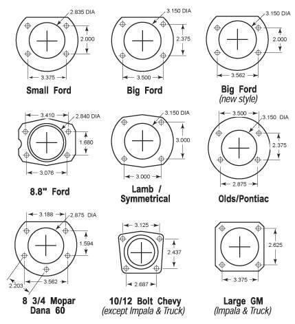

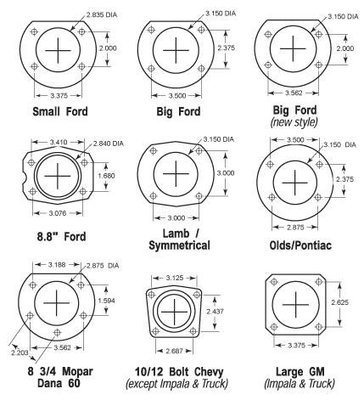

Sure didn't think they're the same. Even with the same number splines (which I think one of the Fords is). Could be the end taper on the Ford is enough to get started on an 8 3/4? You can tell if they're Fords by looking at the bearing retainer if that's there.
IIRC, Ford comes in 28 and some 24. 8 3/4 are all 30.

If it's the one on the left it looks like a taper bearing, does the one next to it have a taper bearing with the outer race laying on it?
8.8 is a good guess.
I've never actually seen one out of a housing.
Initial research indicates 28 and 31 spline on those as well.
