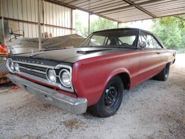

Could someone tell me the width of a gas tank for a '67 Belvedere. My car came with a fuel cell in the trunk and I want to go back with a stock fuel tank. The car was tubbed so I want to make sure there's room before I order a new tank. Thanks...
