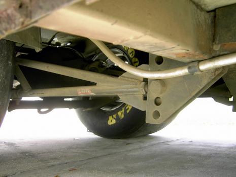

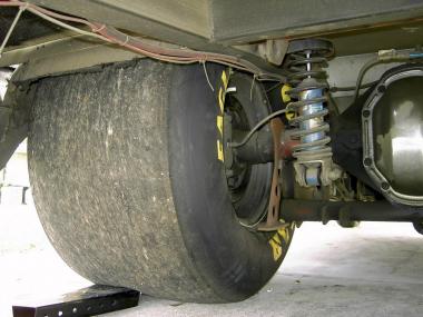

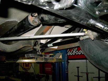

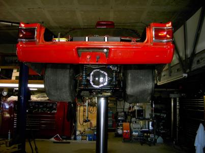

Just in case you were talking ladder bars as opposed to 4 link here ya go. Don,t mind the dirt though this thing has been a race car a long time.

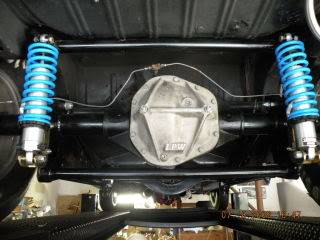

get the chassis engineering triple adjustable setup with strange double adjustable coilovers. you'll love it over any cal trac setup.

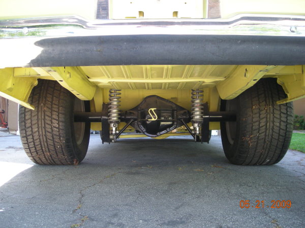

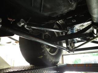

Here is an Alston Chassisworks 4-link setup on a Strange S60 (Dana 60 ).
