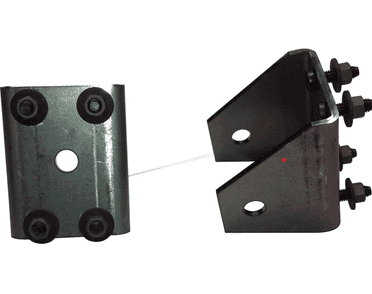

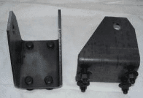

The pictures aren't in the same proportion but you can see the differences in the front hanger. Frame rails were the same....the dodge pushed the bolt hole back farther.
Plymouth
Dodge

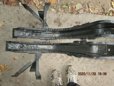

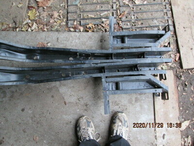

these are the RR rails for sale .......so if it is just those forward mounts thats no biggie?
It opens your search if you are going for original frame rails. 2 door and 4 door 68-70 are the same rails in the dodge/plymouth B line. I'm not sure on the wagons.
In fact the 66-67 2 and 4 door framerails will fit. The only difference is the 66-67's had a transverse fuel tank strap and the rails had the j-bolt slot on one side and the strap slot on the other....and the drivers side had provisions for fuel filler tubes. I put a 69 charger floor in my 67 belvedere....fit like a glove and matched right up with the 67 trunk dropoffs.
Those will do the trick for your charger
