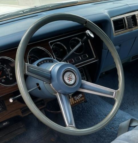

So my 77 Charger has the standard steering wheel. I'd like to get the three spoke wheel. Better yet, a tilt wheel.
I found this one online. But it has a wood inlay and the ones I have seen in other Chargers did not. Is the wood inlay style a C-body wheel? Are they interchangable?
My 78 Monaco has the three spoke, in blue like your picture even. No wood inlay. Chrysler may have added the wood inlay for C body, but might be for a Cordoba vs a Charger those years too.
I think you're right. I saw a 78-79 Cordoba with the three spoke wheel and it had the wood inlay.
The tilt columns were sourced from GM and have a different spline on the shaft. Intermixing tilt and non-tilt wheels is not going to work.
I swapped a C-body Tilt & Telescope from a New Yorker into a non-tilt wheel Newport. No problem. Odd that a B-body one would be different.
