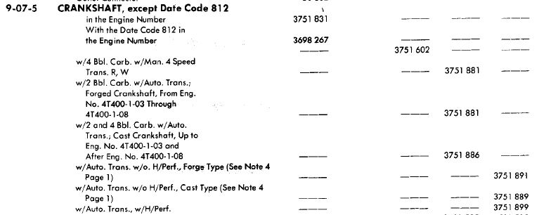

If your block is a 1974 or later it is cut for a "large thrust bearing". It will also take the normal thrust bearing. The large thrust bearing is not necessary in most applications but some people feel if they have a block that can use it, they want to. The picture below is of "B" engine bearings but you get the idea.
I believe it has to do with the cast crankshaft being introduced. My 74 parts manual makes this note when selecting main bearings.
