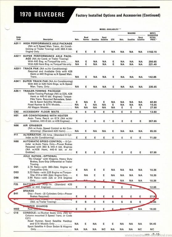

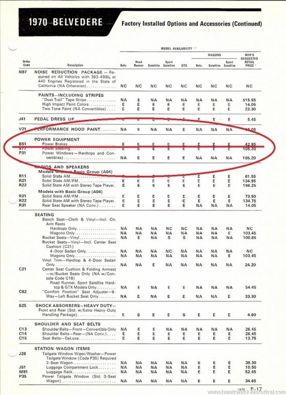

B51 = Power Brakes (Optional, w/Drums Standard)
B41 = Front Disc Brakes (Optional)
B51 & B41 = Power Brakes with Front Discs
