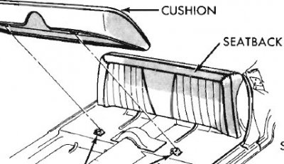

There are brackets at the bottom of the seat frame that slide into a retainer on the floorpan. They are about a foot in from the sides of the seat located on the front of the frame. You need to push the bottom of the lower rear seat back and lift at the same time to release the bracket from the retainer.

Really poor drawing. The floor brackets are hooks facing to the rear and down
The seats have downward "loops" which engage the hooks. You have to put downward pressure while kicking the seat to the rear
