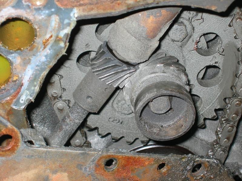

Could be wet distributor cap - could be timing chain - could be striped distributor gear - Just had this '70 472ci Cadillac running fine - next minute back fired and acted like a jumped timing chain - here's how she looked inside due to lack of oiling issue....... Distributor gear jumped a cog from wear.......
Thanks Chicken. Had distributor out earlier this year and looked fine so doubting it is that unless something happened in that time. I had same thought on wet distributor cap but looks fine.
