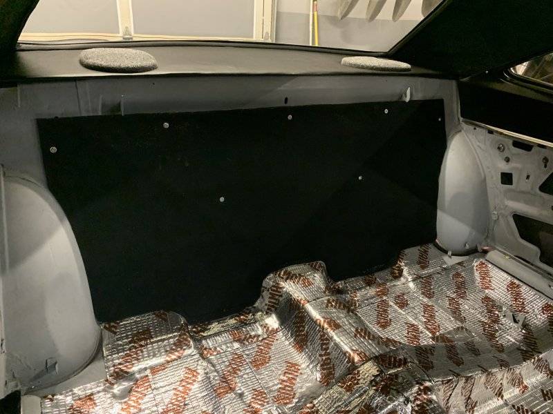

Not difficult to make one- this one is 1/8 plywood covered with padded headliner material.
Make a cardboard template first
I dont know, I did not have one to copy so I had to make a template that covered the hole
