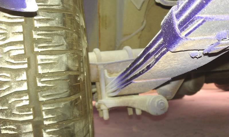

Alright, I test fitted some 15x8.5 mags with what I believe was 4.25 backspacing. As you can see, the rims are quite far from the leaf springs, and stick out just enough to the point where they would rub with suspension travel. These rims came from a duster, and fit fine on that car. The tires on the rims are 275-60-15.
Now, my question to you guys, is can a guy run a 15x10 rim on these car with the right backspacing? And can with either a 10" or 8" rim run 295-50-15's without rubbing with the right backspacing? And what would that backspacing be? Any pics of your rides with similar setups? Thanks!

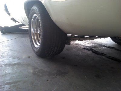

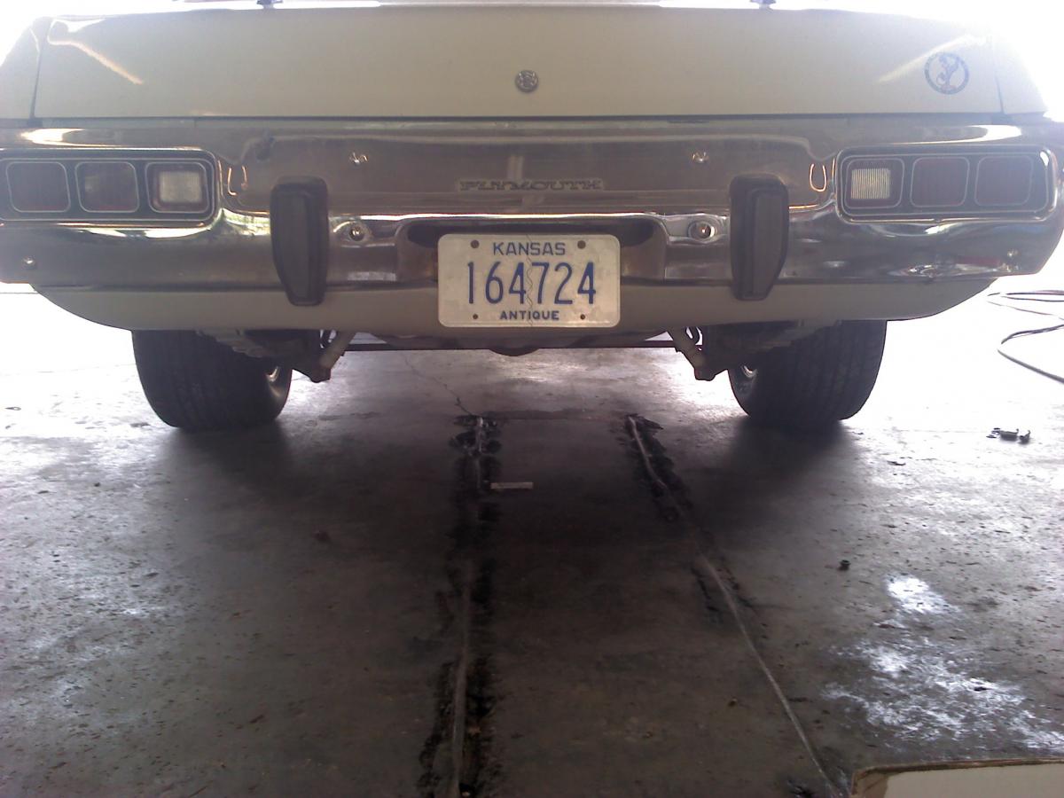

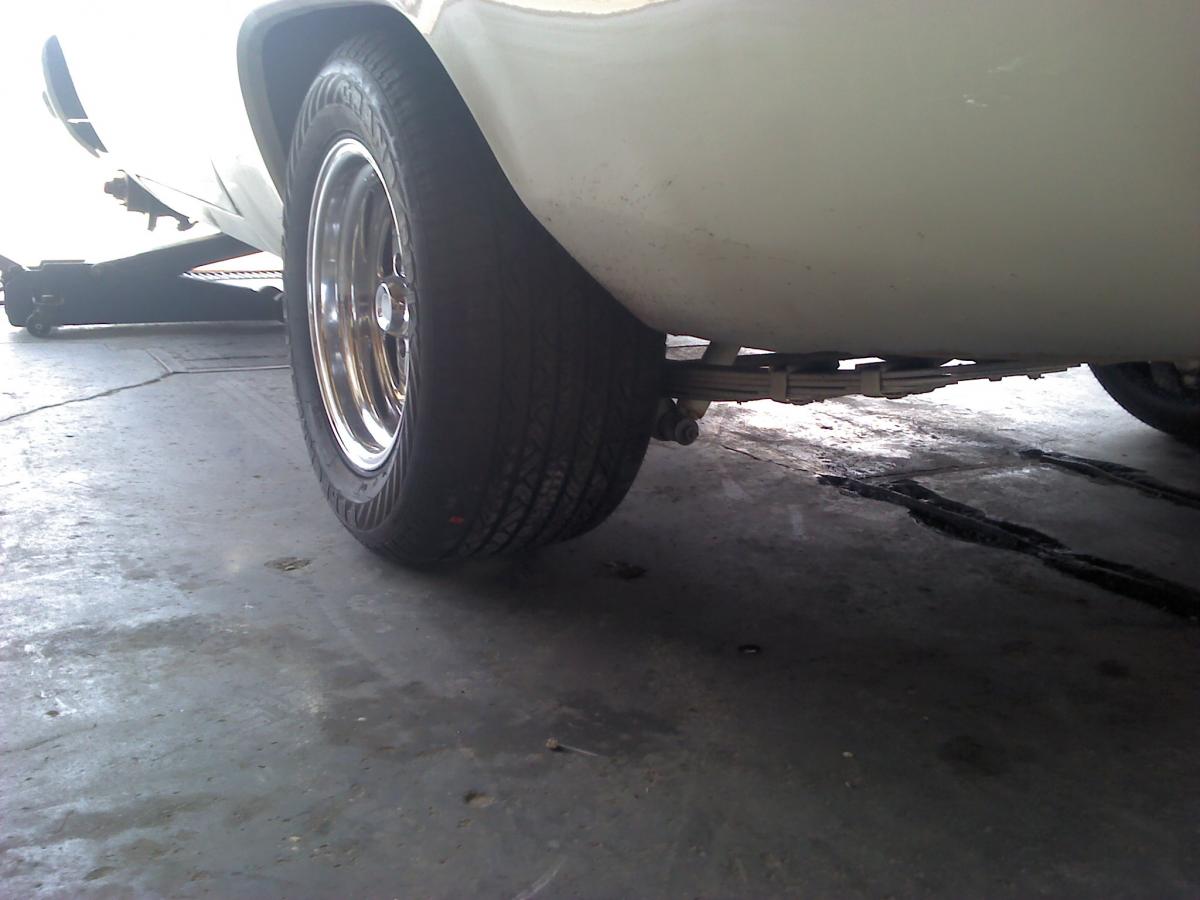

well i went with 5.5 bs. worst case scenario I can use a 1/2 inch spacer.
15x10 5.5" backspacing, and I still have 1/3" space between the leaf spring and the sidewall, as well as 1/2" between the top of the tire/sidewall and the wheelwell lip.

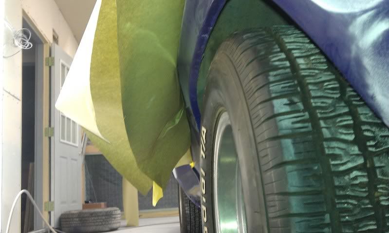

Well, just got my rims from Wheel Vintiques, and my tires. Had a buddy mount them for me. I don't have the trim rings and wheel stuff on the rims yet, just bare for picture.
Rear 295 50 15 on 15x10 mopar rallye, and front 245 60 15 on 15x8 mopar rallye.
