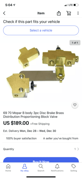

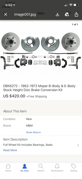

I jacked up the front of my car for 10 minutes, lowered it and backed it out of the garage and zero brake pressure! Soft and to the floor. No front or rear brakes. Fortunately barely rolling so I threw it in park. Turned the car off, pumped the pedal and the pressure came back. MC full of fluid, no leaks anywhere. I have front stock disc conversion kit, non power master cylinder. Used the stock distribution proportioning block when I switched (pic attached). Bad MC? I have a reman from somewhere. Will a Willwood or other bolt in?
