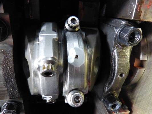

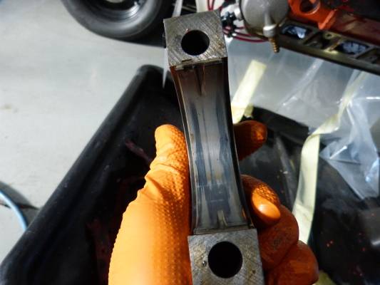

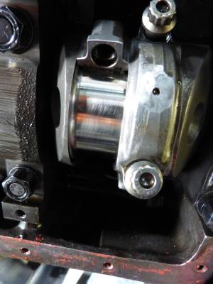

Hi guys , I need you’re advise again .
Engine is gen 2 Hemi 489 with solid lifter and Roller cam .
I give the order to my engine builder shop who build this engine for me After 4000 miles to check the rod and main bearings .
The shop was checking rod bearing 7 and 8 and main bearing 5 .
After the checking the shop put the “ old” bearings in again and say all be normal , was not necessary to install new ones .
After the engine was completed again the shop gives me this pictures from the bearing check .
what do you think about it ?

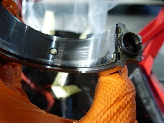

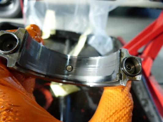

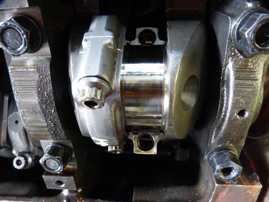

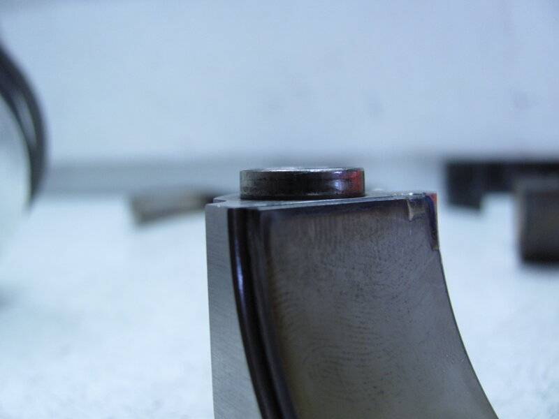

Picture 3 is bearing rod bearing 8 and picture 5 and 6 is rod bearing 7 !
picture 7 is the main bearing 5
picture 8 is the rod bearing when it was new installed by building the engine
I a little confused about rod bearing 7 I not a engine guy, but for me it looks like something lost on this bearing ?
Me personally I would have put all new bearings in after inspection. Bearings are cheap, crank damage is expensive... I’d also pop the crank out and have it checked and the rest of the block.. I don’t do failures and try to make it better than what it was when I started. Some folks get really lucky and take a box of used parts and toss them in and it’s golden... but for how long. I recall Ford/ Mendenhall rebuilds coming in with the bores and journals all different sizes , those were the days of the 3.8 V6 but it was disappointing especially when the failure rate was 50/50 of reman Ford engine at the time...A tech would get very frustrated after completing a install..
Whats up with the main cap fasteners thread engagement - and that main cap with the hole drilled in it?
Those bearings are going metal to metal in my opinion. I have seen that if there is not enough clearance or the wrong oil.
After 4000 miles those bearing shells should still look like new.
Sorry , I have no idea about the main cap hole and the thread on main cap , I only worry about rod bearing 7 . I not a engine guy , full Rookie in engine things , that’s why I ask for help . Because I can’t believe the bearings are good , like my shop it says to me ... can not trust and believe
First I want to know why you wanted the bearing checked in the first place? was there an issue?
it seems ludicrous to me to pay thousands to have that bottom end torn down again and not just spend the couple hundred it would cost to put new shells in it. and why are you having it checked again, not that its a bad thing, but I'm sure it's not cheap... I've pulled apart 60,000 mile 440's that didn't look that bad.
I personally have no issue reinstalling a good bearing in my own motor. Customer motor that's a bad practice. The bearing in pic 5 has definitely touched the crank while running. In the picture it appears smeared next to the locating tab. That one would be diagnosed and replaced. Agreed the main studs look short.. I'm not a fan of the threaded hole in the main cap either. Who is this "engine builder"?

Thank you very much for you’re advise ! The engine Builder is the Moparshop in Germany , and he also check the bearings because I ask for it, just after 4000 miles slow drive ( no race ) and he also put this bearings in again and say to me it just normal wear . Nit necessary tk change in new ones ..... I can’t believe it too

New bearing shells is not going to fix the problem - it may just do the same again.
Loss of oil pressure would not have helped.
You need to find out the root cause of why the bearings wiped in the first place.

What you mean in the first place ? Main Bearing 5 or rod bearing 7 ?

After your last post and reading the information in it I cannot come up with an answer why an engine would suddenly lose oil pressure 3 times and then be "OK"
I have done a few engines and never had that problem. Any loss of oil pressure is bad ****.
Replace all the bearing shells (main and big end) check all clearances and find the cause of the oil pressure loss is my best advice for you at this point.

I would go to the oil pump and check the drive shaft for it. Those bearing's are cheap enough that I always replace them when doing the bottom end on a car. As well as my main bearing's. Two of those pusher rod bearing's do not look so good. Yes one is whipped out not a good sign. Or called burned. Lack of oil to it. Wish you luck do it rite the first time. If you build the top end always build the bottom end also. Seen too many guys bolt on part's for the top and rework every thing and did not touch the bottom end and low and behold it let go.
Non stock oiling system? Ill bet it has air leaks (losing suction) fix that first or your bearings will get worse looking every time the oil pressure goes away
If your engine knowledge is limited I would take my time to find another engine guy. There has to be some knowledgeable guys in your country.
