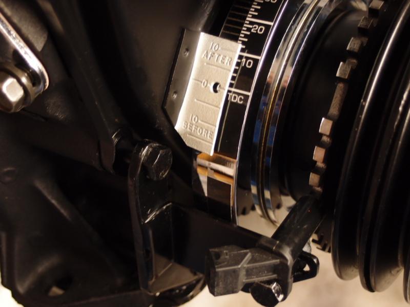

I run a Fluid Damper with one. It lined up perfect.
Doug

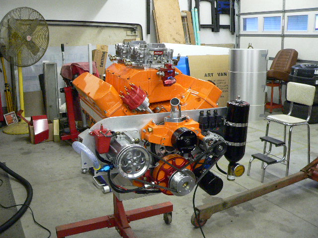

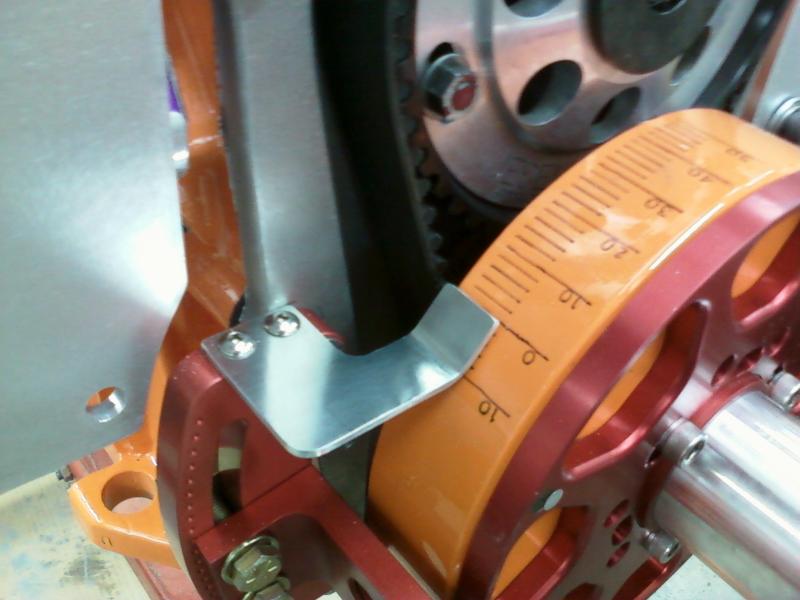

Home made crank trigger
Here is my home-made crank trigger. The tooth wheel is the ring style from a British firm and welded to the standard pulley.
I'm running a damper from 440Source, just standard stuff. My crank trigger setup didn't cost much.

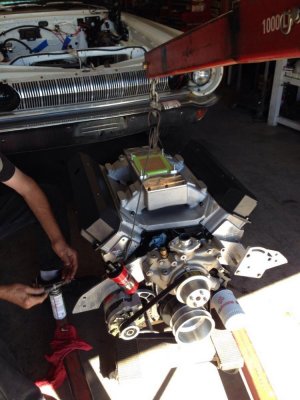

I have a fluid damper on mine. Here's what my setup looks like. I just don't see how I could bolt it up and run this dual serpentine pulley

Can you get me a couple more pics? Did you drill and tap the pulley to allow the trigger to bolt to it? What's the part number for your pulley?

The holes are already in the MSD wheel. It's only about a 1/4" thick. You could space your other items further out to fit. Or is there enough material at the back of your lower puley to remove the thickness of the trigger?
Or cut the back half of your lower pulley off (I'm assuming it's aluminum) and weld it to the MSD trigger wheel. Lots of options.
Doug
Looks like I would have to put a spacer behind the trigger wheel to get to flat at the front of the pulley. Then I could space out the accessories to work
