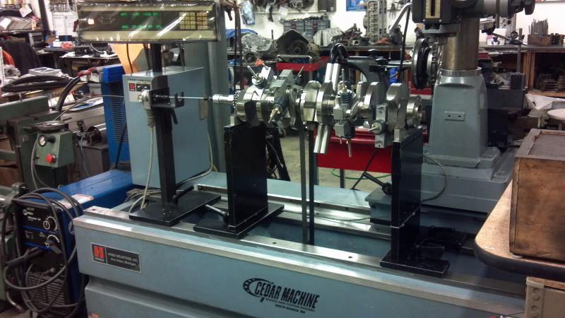

Working on this right now. Thought it was kind of cool. 2014-02-25_22-01-03_102.jpg

Do those have offset rod journals? If so how does that affect the bob weights? I'm guessing the bob weight formula is a little different than a V8.
Actually, being that the throws are evenly spaced every 72 degrees, the bobweight is still 50% reciprocating and 100% rotating
That makes it easier. I just remember seeing those 90 deg offset ground V6 cranks and wondered if those had to have a bob weight on every rod journal - then thinking the Viper crank was similar.
Yes, the V6 cranks vary from 37.5% to 50% reciprocating. They are odd ducks. If you notice, one of the throws on this Viper crank has two V6 bobweights on it :) I don't have 5 twin assembly weights, only 4 for V8's.
They work the same. I've moved the pair around with no change.
Yeah, I saw the center looked different.
