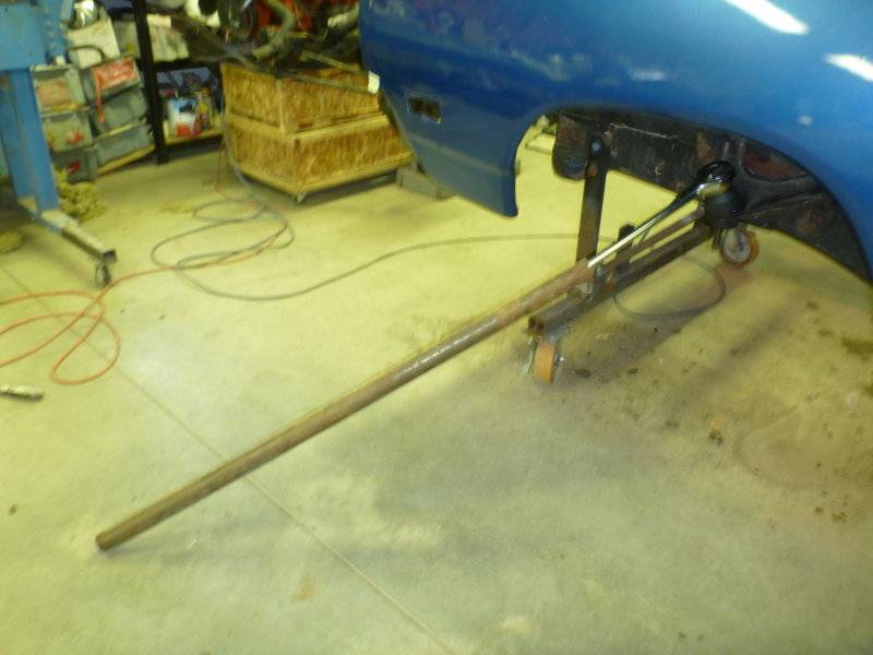

Now that's what I call a snipe!
Better be careful with a cheater that long. My 3/4 ratchet exploded on day when I was "rowing the boat" tightening up a set of u-bolts on our Frehaugh trailer one day. Almost broke my buddies hand when it exploded. Well he said it hurt like hell anyway lol
Funny how the pipe that goes between the dolly legs is just the right size for the handle of a 3/4 ratchet.
Careful with forcing the ball joint out that is threaded and using a cheater isn't necessarily a good thing as that much friction may destroy the shallow threads that are on the a-arm, ask me how I know! I would suggest using a bit of heat on the a-arm to expand it and remove the ball joint easier once you get the correct socket.
